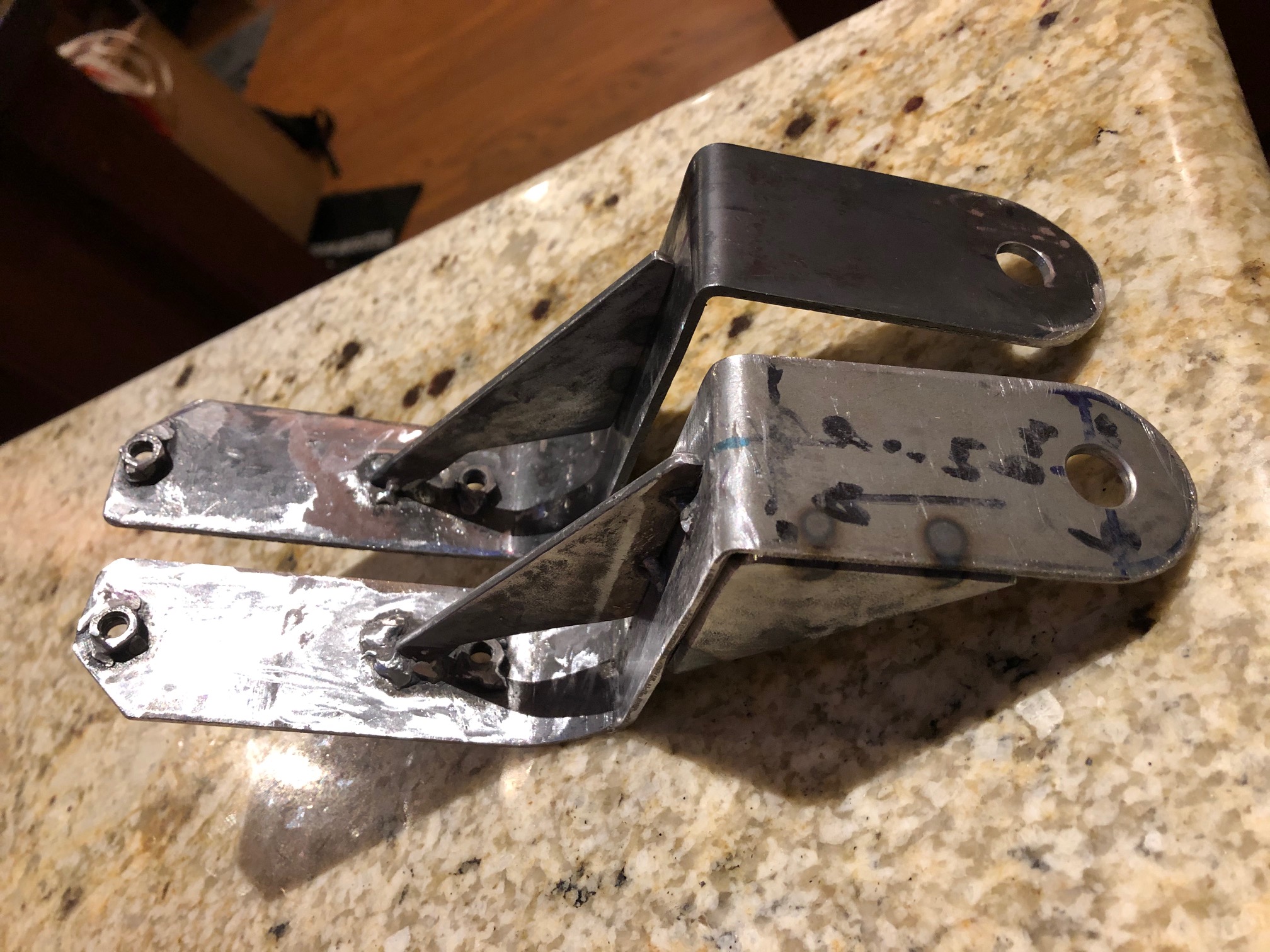

So the brackets themselves (as the pics show) look pretty basic on the face of it. But some thought obviously went into the design, as they need to meet multiple criteria:
- be shaped such that they can be fed through the inverted “T” cut in the bumper
- secure the bumper to the body
- have welded in bracing to prevent the lights vibrating & flexing
- clear the front valance mounting tabs (which are just below the bumper mount holes)

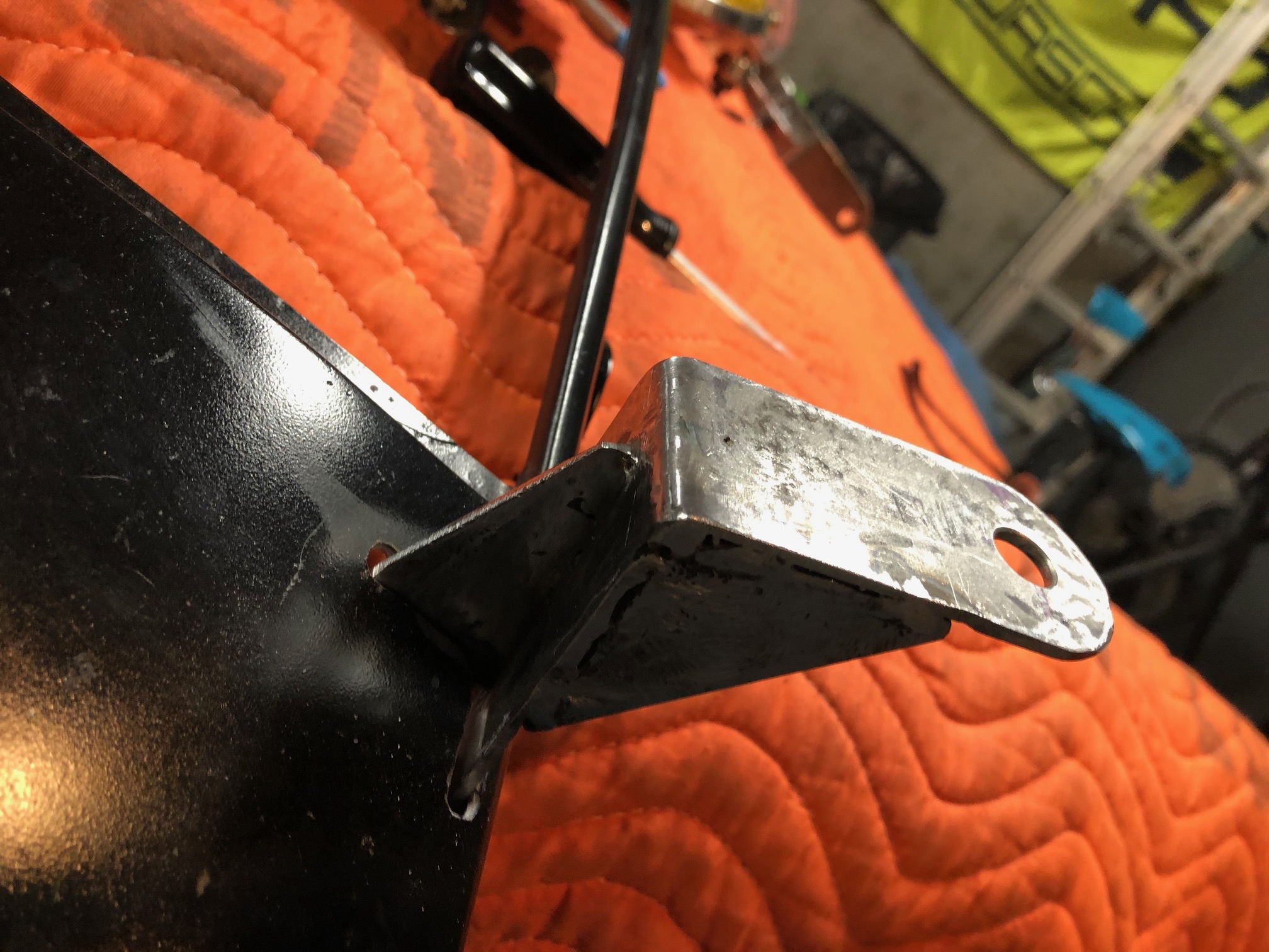

The upper piece in this shot shows the side profile I went for, bent up in aluminum as a test for clearance; one of the main bracket is being fab'ed using mild steel.

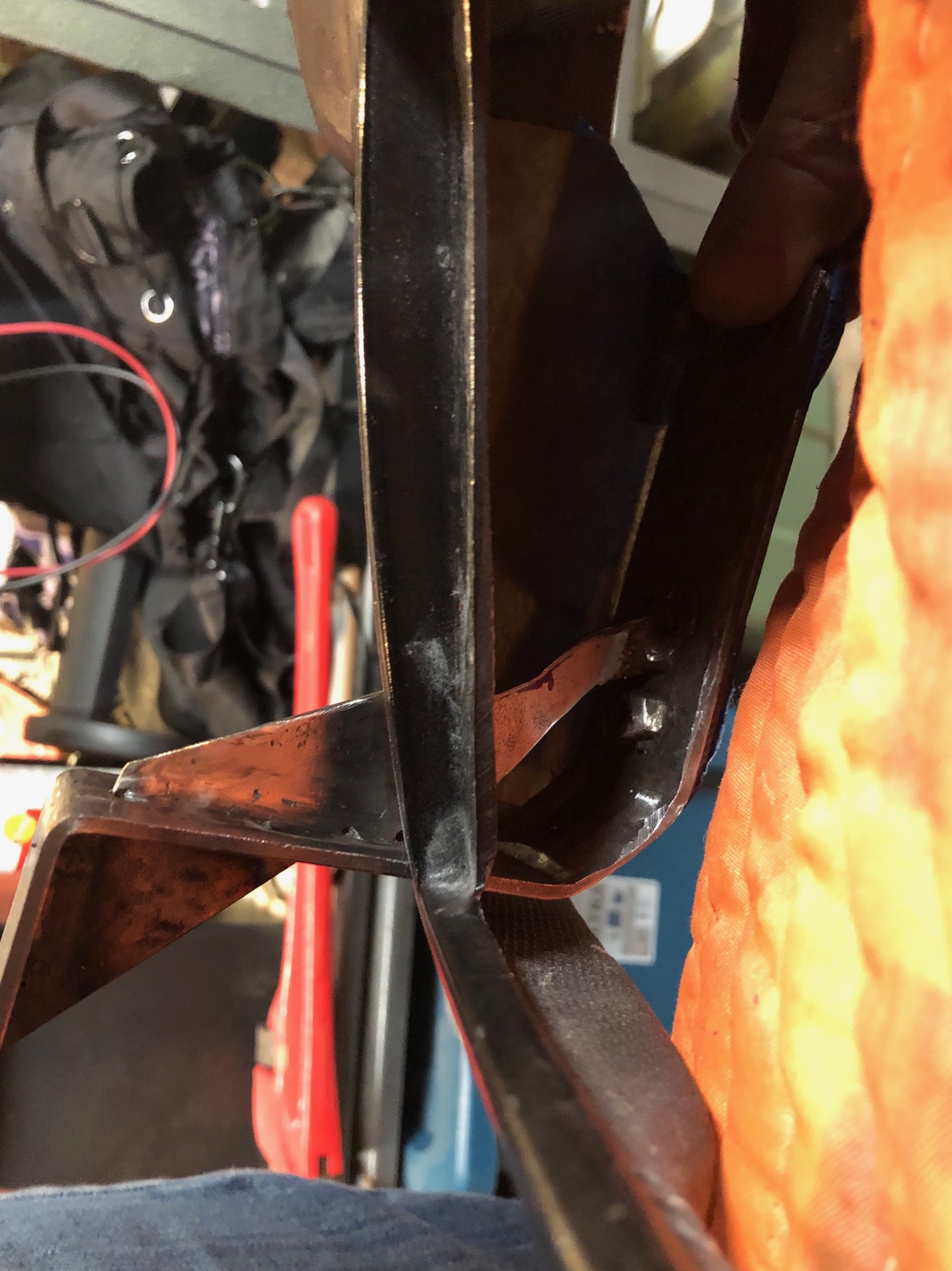

The cut in the bumper (fiberglass) was done with fingers crossed but turned out to be correct, the shot below shows a test fit & alignment check before cutting the vertical:

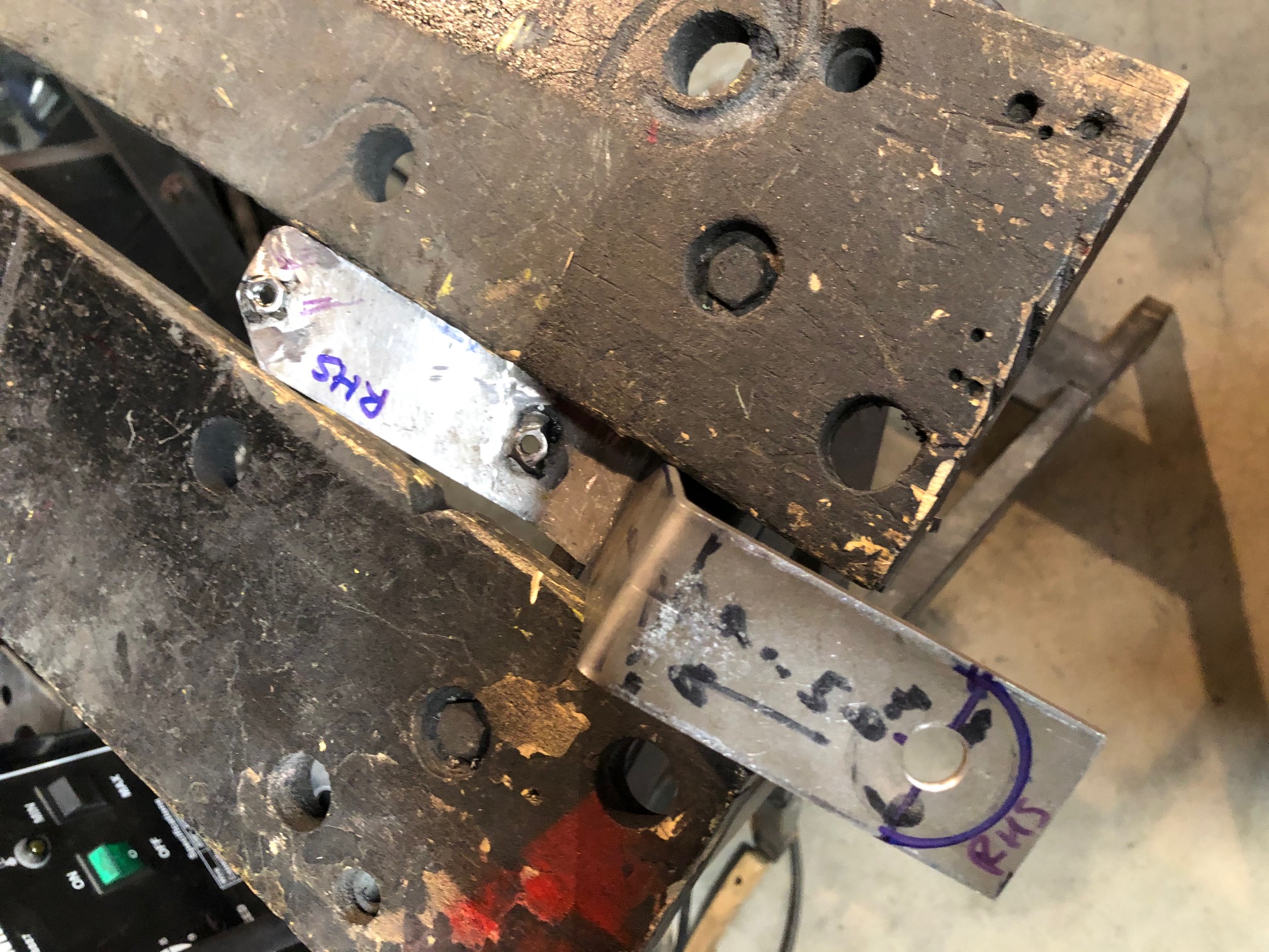

I welded some M6 nuts to the strips to use as mounts, aligned with the holes in the bumper and the body. Cutting the bracing pieces needed some experimentation and mocking up, as looking carefully at the existing photos of the OUTSIDE, it was hard to judge overall dimensions – extension, drop, etc. – so in the end it was basically a visual judgement call.

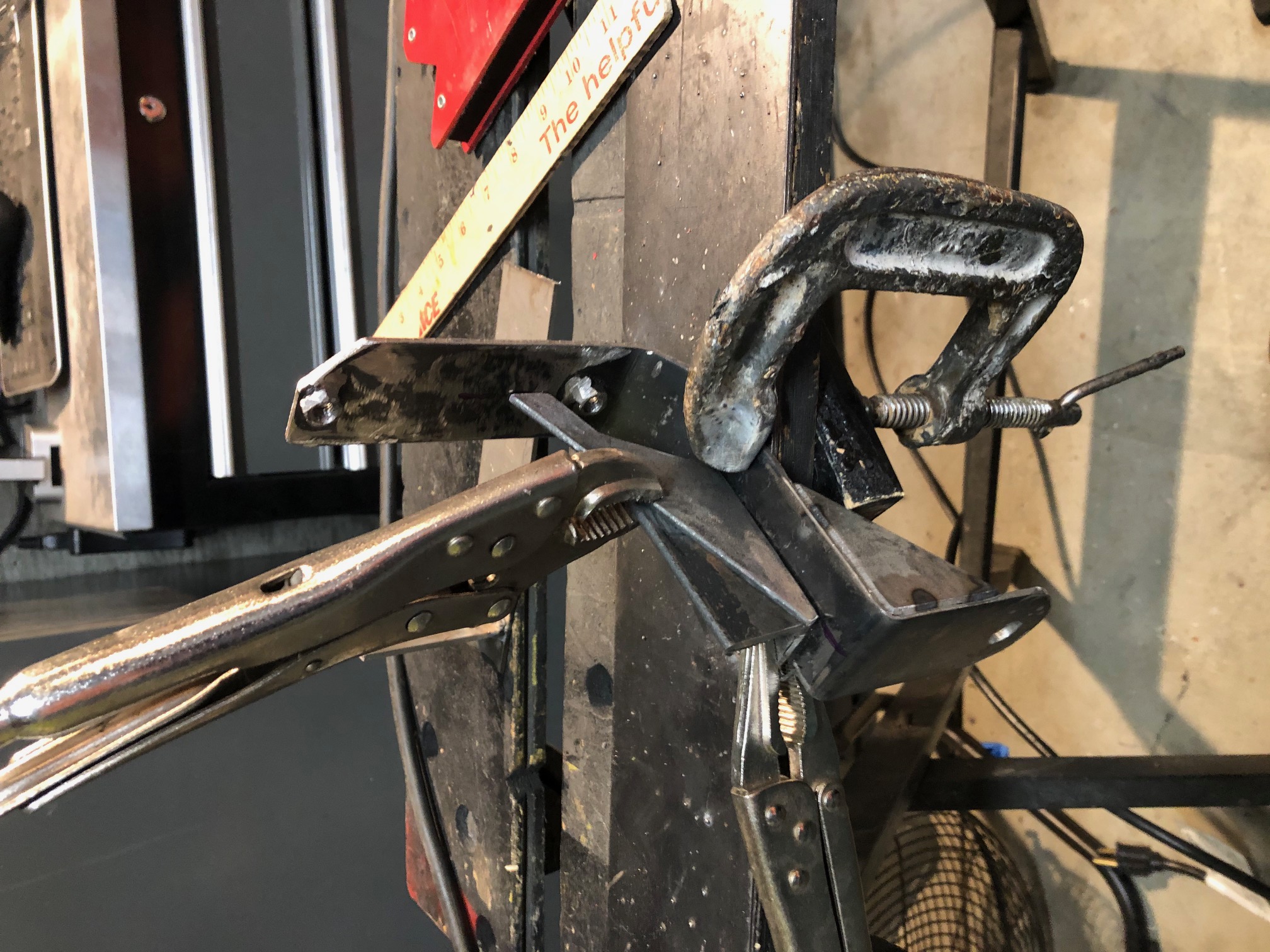

So on to welding and shaping (lower shot shows braces tacked in):
My welding is quite poor, but I am a dab hand with a grinder ;-) so I went for adding metal and grinding back for a smooth finish on the brace pieces – rather than the “stack of dimes” welds on the originals which I assume were done using aluminum stock - and stitched together by a competent welder. One element that took some degree of hand fettling was the profile of the bracket so that it could be fed into the front of the bumper, so the central brace required some metal removed, as well as the upper part too – not obvious, but part of the three dimensional insertion problem!
