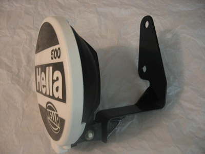

mlindner   I went a little the other way...from the top down....   Sep 14 2020, 03:01 PM

914forme   If your running fiberglass bumpers I would not fee...   Sep 26 2020, 08:20 PM
