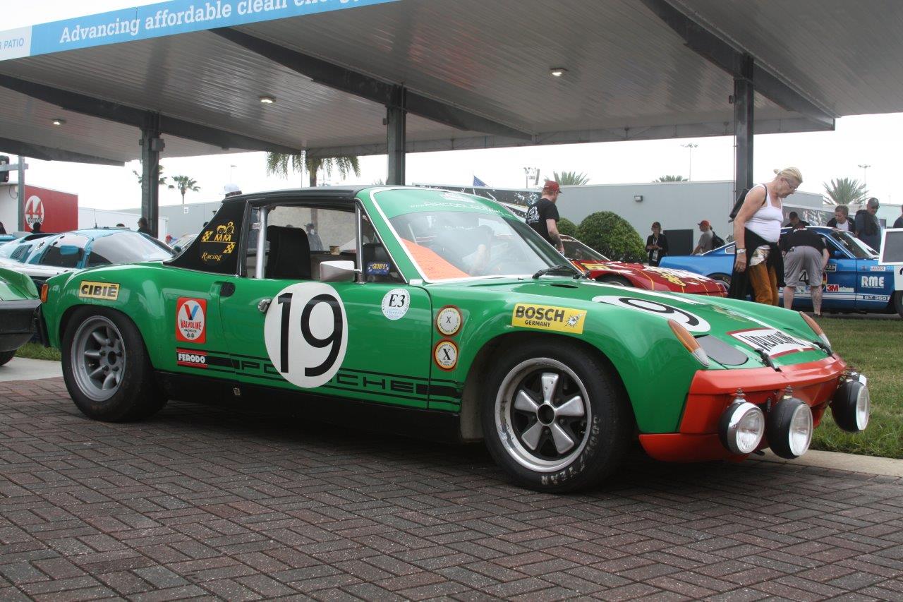

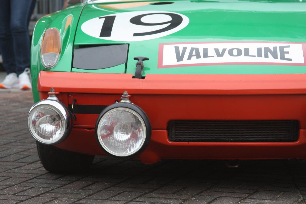

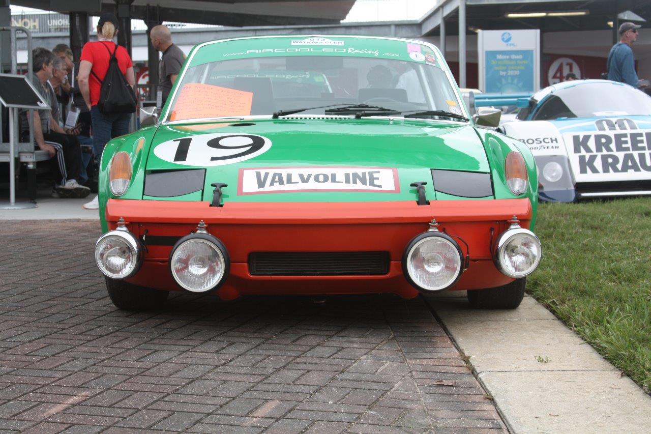

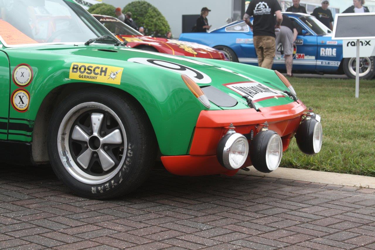

Nice work on your brackets. When I read your thread I thought of the historic 914/6 GT I took photos of at this years Rolex 24. The auxiliary lights were mounted differently and appear to be mounted to the exterior of the bumpers. If I had seen your thread before the race I would have checked the mounting more closely.
