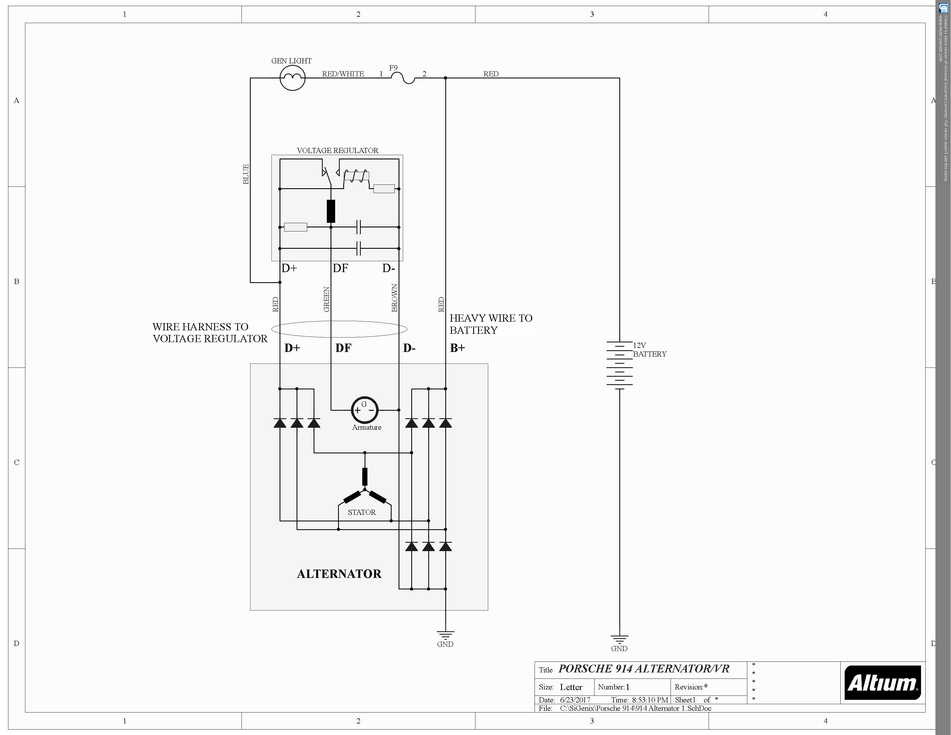

About what could happen if the battery was reversed; check out the 914 charging circuit diagram below. With the battery connected correctly as shown, all the diodes in the alternator block current from the battery.
When the battery connection is reversed, the diodes are forward biased and shorted across the battery and will likely be damaged.
