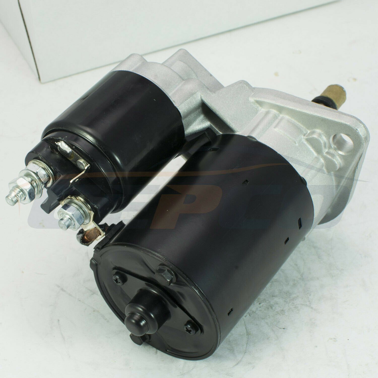

I took a photo from ebay, I am guessing the negative is the terminal that is not the positive (IMG:style_emoticons/default/biggrin.gif)

QUOTE(dt4 @ Feb 12 2020, 02:36 AM) *
We still have some conceptual work to do.
The entire car - everything metal is negative. So, the negative lead should be connected to the starter chassis or a point close to the starter. See the red circle in the picture.
We are testing the connections from the neg term on the battery, through the car to the starter, there is a ground strap that connects the engine/trans to the chassis - this may be a problem.
