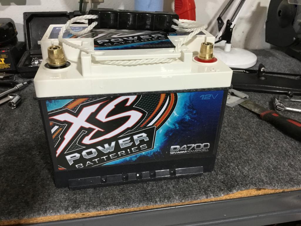

Received my new battery today from JEGS.
Man is it ever heavy (~42 lbs) compared to the Lithium I'm replacing (~11 lbs).
The new battery has a bunch more Amp-hr.
62 Amp-hr vs 30 Amp-hr for the Lithium.
Should do a lot better keeping up with the electrical load while driving around, sitting at stop lights, etc.
So it's an XS Power battery, model D4700.
This is one of those AGM batteries so acid leakage won't happen.
Specs:
12-Volt
CA: 760
CCA: 668
Ah: 62, 2000W / 3000W
Max Amps: 2900
Reserve Capacity: 110 Minutes
I purchased mine for $279.99 including shipping.
I think the price is very competitive for this type of battery.
Also needed is a set of battery terminals for another ~$10.
Some might not like the flashy looks, but I think it's fine.
You could always come in with some cut vinyl to hide them....
ps I did have the battery terminals reversed for this pic. The larger one goes on the positive terminal. Ha
