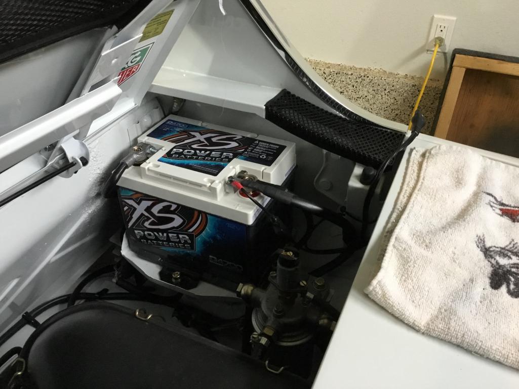

So the real important thing for me is fit in the car.
I obviously did all my measuring before purchase and this battery looked perfect.
And it was.
Fits the stock battery tray perfectly.
Even the stock hold down clamp works nicely.
This battery has the necessary "cleats" front and back such that it is very secure when clamped in place.
Not too tall.
Can't tell you if the rain tray would get in the way as I don't run one with my six.
Another super important thing is that the terminals are in the correct location with the negative closest to the firewall.
It was like this battery was meant to go in a 914.
I may get a bit creative with some vinyl and some graphics to change to cosmetic looks of the battery, but that's a minor issue in my mind at this point.

raynekat   Received my new battery today from JEGS. Man is i...   Feb 15 2020, 02:57 PM
raynekat   So the real important thing for me is fit in the c...   Feb 15 2020, 03:03 PM
