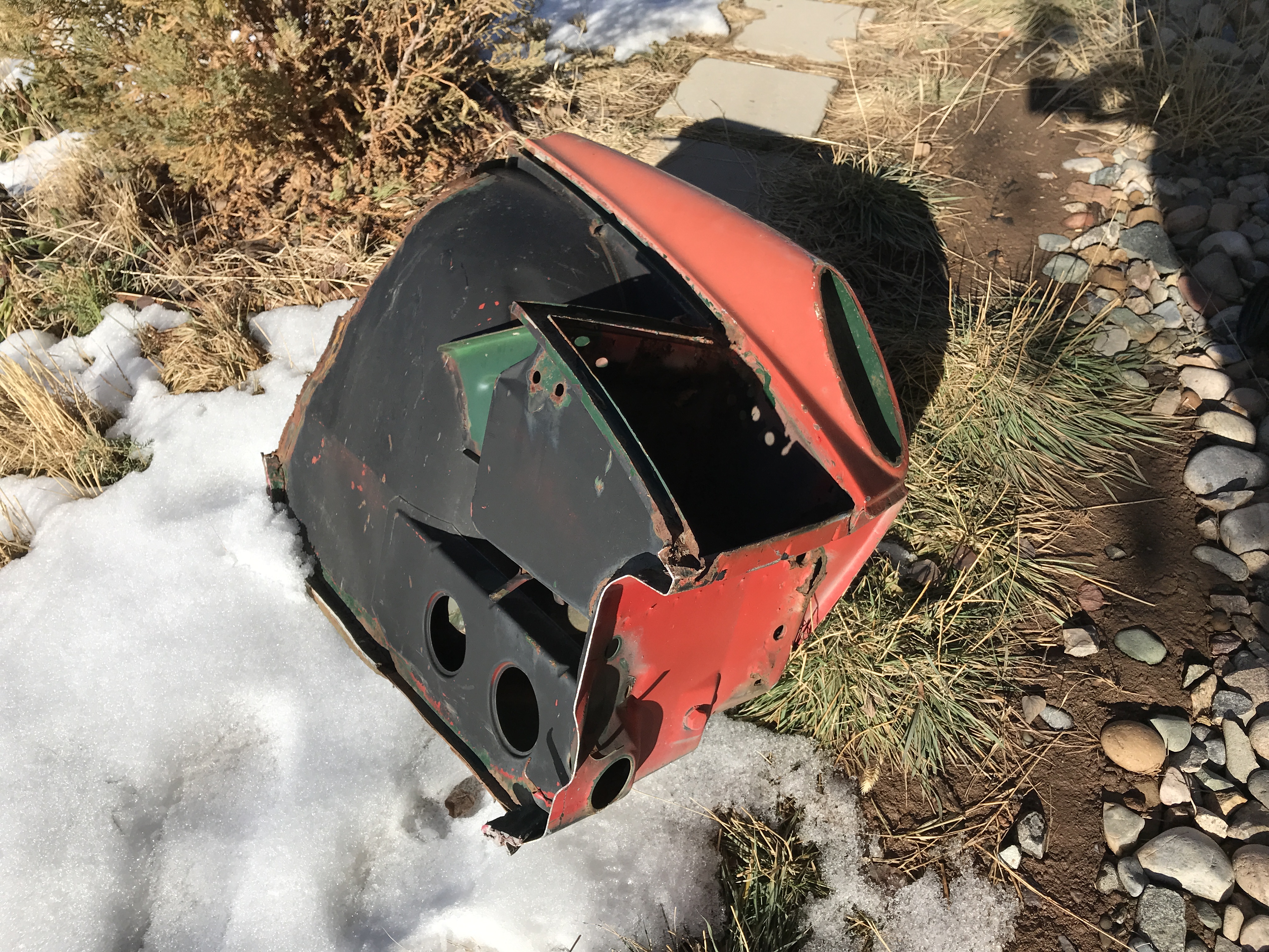

I have a front left corner you can have for the price of shipping.

bkrantz   I have a front left corner you can have for the pr...   Feb 15 2020, 09:13 PM

sreyemj   I have a front left corner you can have for the p...   Feb 15 2020, 09:22 PM
