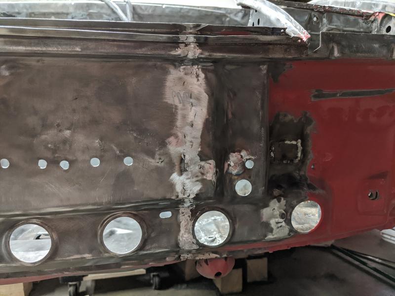

sreyemj   Done with most of the cutting. I had to back off ...   Apr 4 2020, 11:36 PM

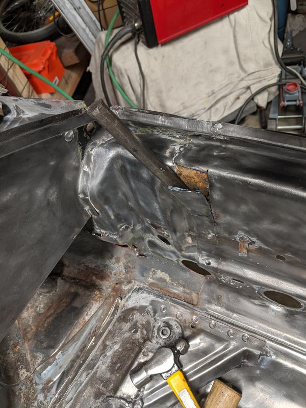

Superhawk996   The rear suspension console has some welded repa...   Apr 5 2020, 09:07 AM
bbrock   :headbang: Scary stuff. I found braze in my su...   Apr 5 2020, 09:14 AM
