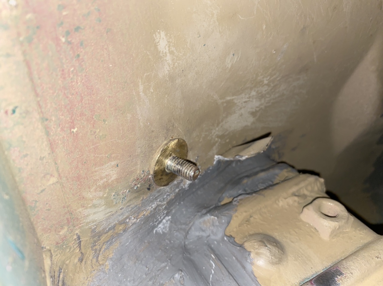

Having a bit of a wtf moment now
This is the connection for the battery negative lead
Using a new negative lead and it’s still a bad earth
If I add the jump lead from the engine to the battery negative it starts fine but with the negative lead alone it won’t turn over Attached Image

dt4   Having a bit of a wtf moment now This is the conne...   Feb 17 2020, 11:03 AM
DickSteinkamp   It certainly sounds like the engine is not getting...   Feb 17 2020, 11:23 AM
Spoke   Is that the stock ground stud? Maybe it's not ...   Feb 17 2020, 11:24 AM
sixnotfour   pic = 1000 words   Feb 17 2020, 11:40 AM
dt4   pic = 1000 words I have cleaned that one up b...   Feb 17 2020, 12:32 PM
sixnotfour   pic = 1000 words I have cleaned that one up ...   Feb 17 2020, 04:23 PM
Spoke   I have cleaned that one up but will go at it agai...   Feb 18 2020, 04:51 AM
dt4   I have cleaned that one up but will go at it aga...   Feb 18 2020, 06:38 AM
dt4   pic = 1000 words so I removed this earth strap...   Feb 18 2020, 02:30 PM
ctc911ctc   pic = 1000 words so I removed this earth stra...   Feb 18 2020, 02:40 PM
