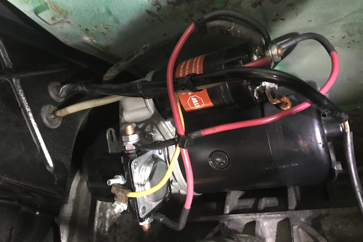

Mark, I've been fighting hot start (i.e. no start) issues for some time and came across your thread. Followed your instructions and voilĂ  problem solved for under $50! The only thing I wish I'd had is a custom bracket for mounting...but gently bending the tab and securing under the lower starter bolt works really well. Thanks so much for posting how to fix this! Much appreciated my friend!
