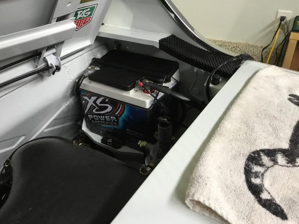

Here's what the battery looks like with one of the covers on it....
Helps to clean up the look a bit.
Got cover from AA and it fits perfect.
Wonder how long the rubber band will stay in one piece?
