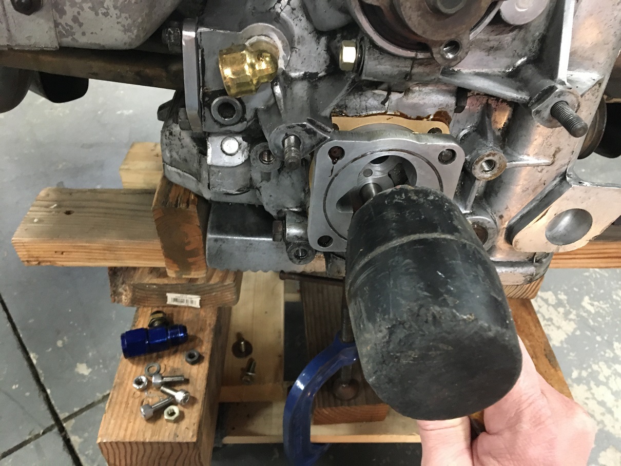

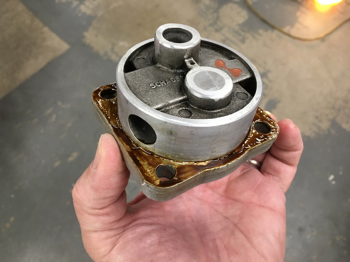

For the oil pump installation, I read here that Permatex sealant 80019 is recommended for this task. Paper gasket and gently pushed into place.

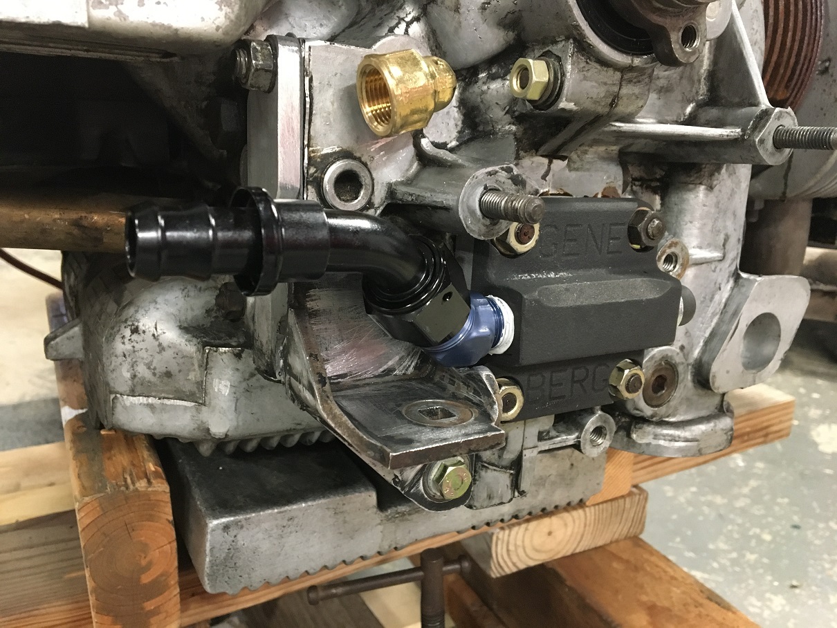

Since I want to do a final validation of the various clearances between the blue AN elbow on the pump cover, the engine mount, the mount upper bolt head, and the mating AN female fitting, I used the pump cover without any gasket or sealant and torqued down the nuts to set the pump itself.
About a week later, I removed the nuts on the cover and began the clearance validation... There was a small interference between the blue elbow and the upper mount bolt so I filed away some of the fitting boss that is used for tightening it in place. Luckily not much was needed.
First try, almost there:
End result on the fitting (IMG:style_emoticons/default/dry.gif)
Here is the clearance between the blue elbow and the engine mount:
And here is everything including the rubber mount stud and mating female AN fitting.
This setup will work but I am not 100% pleased with the outcome as it is a tight squeeze. There are better ways for achieving this. Mark Henry's engine mount modification and straight out fitting at the cover is more elegant. It requires more fabrication on the mount but it is much cleaner. McMark also has a version where he modifies the pump cover to have the outlet on the face instead of the side. With a 90 deg elbow screwed on the face of the cover, everything is cleared. This requires a cover with sufficient thickness to have enough thread engagement.
