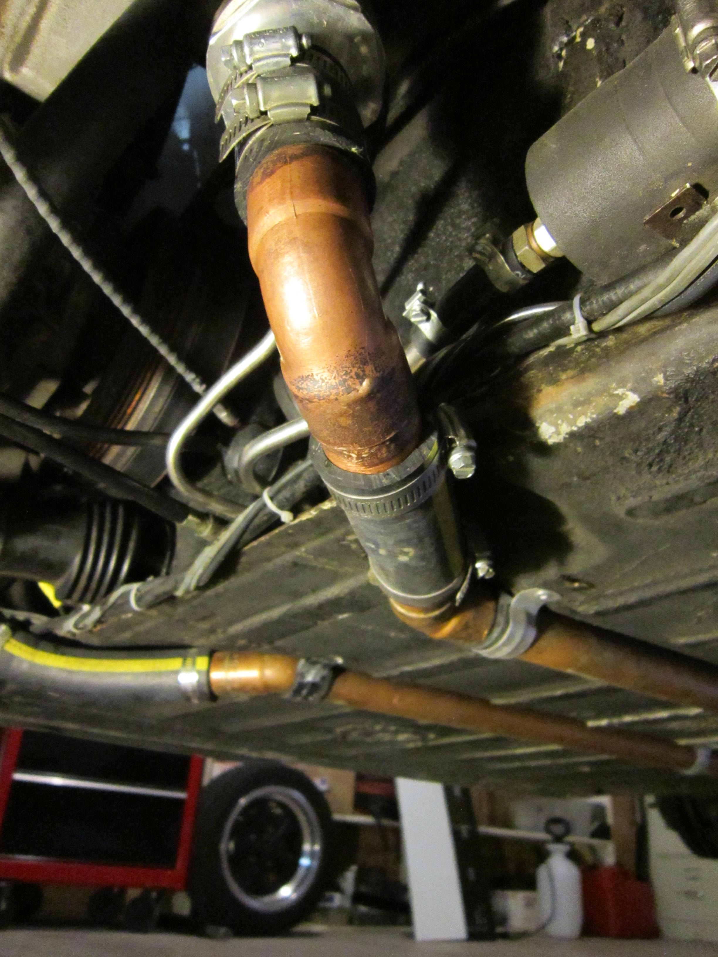

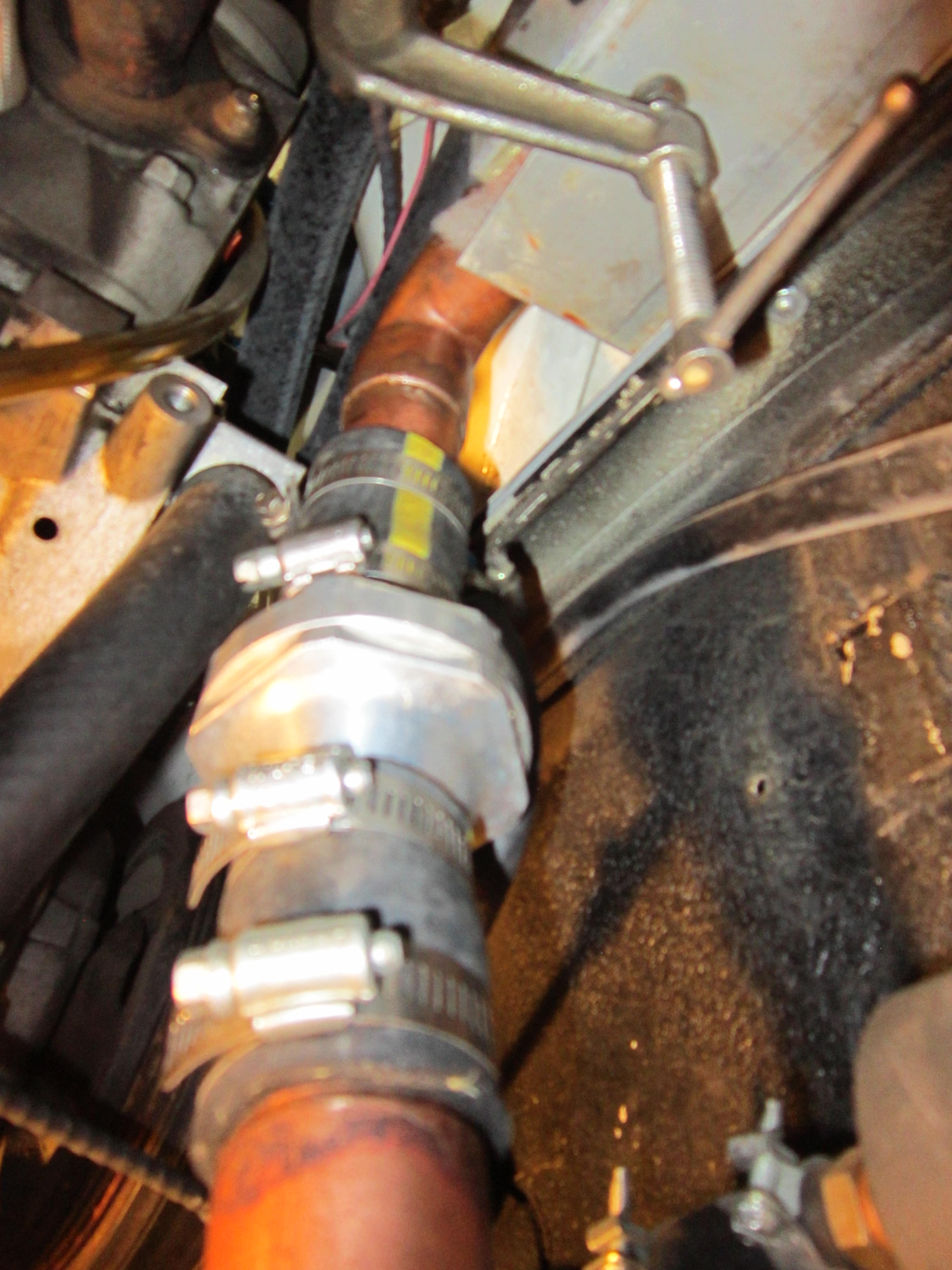

Got it ! My original idea to put the t-stat near the engine in the hose leading to the radiator was correct, but failed due to my lack of understanding of the electric water pump being used. It has no internal bypass.
Realizing that & using a trick picked up from old school racers, I drilled 4 x 1/8" holes in the t-stat flange & re-installed it in the outlet hose from engine to radiator.
Coolant temp went up to 197*, then dropped back to 194* when the 195 * t-stat I'm using opened.
So happy to solve this problem. Thanks to all who helped me along to this solution !
Terry (IMG:style_emoticons/default/driving.gif) Attached Image Attached Image
