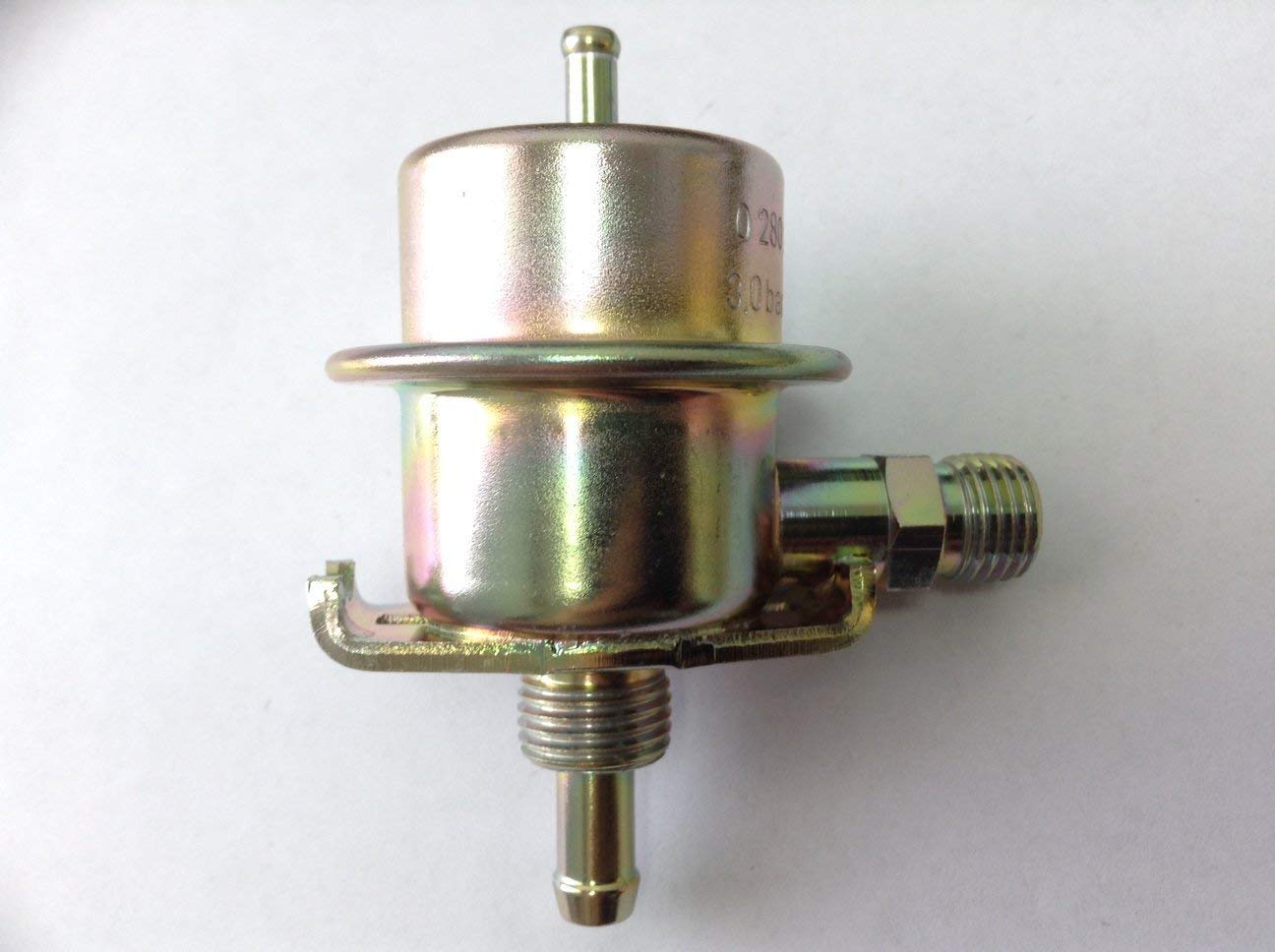

Knowing that 914 l-jet regulators are a direct swap (fitment wise) I started exploring what might be out there the the realm of cars that used similar systems.
914 L-jet regulators are non-adjustable, vacuum referenced and is supposed to give ~37-38 with zero vacuum. Those can still be had available new but isnt quite where we want to be...
Vanagon regulators are similar pressure wise
and then by some random luck i stumbled on this...
Bosch 0 280 160 256
vacuum referenced, 3 bar non adjustable. Would need an adapter on the inlet but other than that appears to be externally similar to a stock regulator.
https://www.amazon.com/gp/product/B00C818WG...45-cd78f07a84d8
This has some interesting candidates as well though i am not sure where they can be purchased. FPR 05-40 B (adjustable from 0.5 to 4 bar) and FPR 15-50 are of particular interest.

GregAmy   Here's a 3-bar one. eBay ad claims (I think) i...   Mar 10 2020, 07:31 AM
GregAmy   Am I correct in inferring his non-regulator one is...   Mar 10 2020, 09:24 AM
JamesM   Am I correct in inferring his non-regulator one i...   Mar 10 2020, 01:13 PM
GregAmy   Mario's response, paraphrased: This: Univers...   Mar 10 2020, 07:14 PM

GregAmy   Mario 3-bar FPR procured and installed. Shows 41.5...   Mar 13 2020, 07:52 PM
