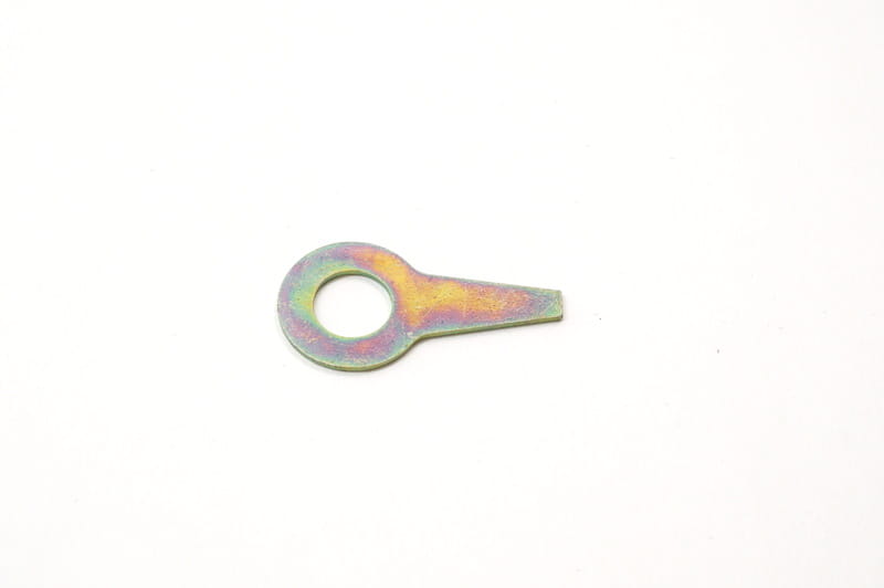

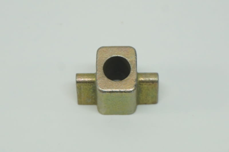

Add Clutch Tube Broke Loose to the List.....
you need these 2 parts,without a doubt..
the clip get from 914rubber
