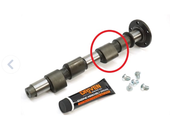

I should like to point out that the 914-4 engine is a derivative
of the good old VW engine designed by Dr. Porsche way
back when. As the "people's car" everything, including the
engine, was designed for cheap mass production. As part
of this philosophy, Dr. Porsche reasoned (I take license here)
something like this: "Why should I design a typical 4-cylinder
engine camshaft with 8 lobes, when I can get by with half
that number?" Due to the flat-four layout, each cam
lobe does double duty, actuating a valve first on one side of
the engine, and then on the other.

It follows logically that a valve opposite one that is open is
on the back of the same cam lobe, the perfect place for
adjustment. It is only necessary to be certain of which
valves actually share the same cam lobe, which can be a
little tricky owing to the offset nature of the cylinder layout.

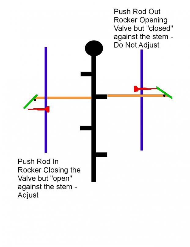

First, a definition of the term "rocking". The name that is usually
applied to the levers that convert the direction of travel of the pushrod
(out) to valve motion (in) is "rocker arms". Therefore, by definition,
rocker arms "rock", or pivot about the "rocker shaft", the gizmo that they
are mounted on. So "rocking" is observed movement of the rocker arm for
the valves mentioned in the first column of the table.
Once you have the PAIR of valves in the FIRST column of the table open
(rocker arms rocking, rather than in valve closed position) it is then
correct to adjust the CORRESPONDING PAIR of valves in the SECOND column of
the table (on the same line, or row of the table).
In other words, you would rotate the engine (by turning the
road wheel with the car in gear) until the # 2 exhaust and
the # 3 intake valves were observed to open (observed
motion of their rockers). When you have both of these
valves open, you can then proceed to adjust # 4 exhaust
and # 1 intake. This completes the first line of the table,
and you have two valves adjusted. You then proceed to
the next line of the table, and look for motion of the "que"
or "indicator" valves in the first column, and adjust the
valves in the second column. This process continues
until you have completed all four lines in the table,
adjusting two valves per line.

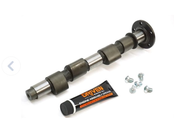

However, this needs a picture:
Here is the camshaft of a typical 914, your lobes may vary. So now Krusty Explores the simpler method

What he is saying is Exhaust for Cylinder 1&3 uses the lobe circled.
And, the intake for Cylinder 2&4 uses the following lobe that is circled.
Now- focus on the intake valves for Cylinder 2&4. When the valve in Cylinder 2 is being opened by the lobe it MUST be closed on Cylinder 4. So you can adjust the intake valve on Cylinder 4. VERY CLEAR?

NOW THIS IS WHERE IT GOT VERY CONFUSING FOR ME.
The original explanation promises that this is a method that one person could perform. However, in the chart, I was mystified as to why I have to look for 2 valves rocking on opposite sides of the car?????? Example: 2 AND 3, etc.
I imagined (prior to thinking about this) that there was a position where #2 Ex and #3 In may not be in sync. This is not the case. THEY CAN NEVER BE OUT OF SYNC since the lobes are 180Deg out of phase.
This is where the Sun rose above my marble head.
The logic in the chart is wrong! This is the correct Logic:
Turn until Rocking: Adjust:
#2 Ex OR #3 In #4 Ex & #1 In
#1 Ex OR #2 In #3 Ex & #4 In
#4 Ex OR #1 In #2 Ex & #3 In
#3 Ex OR #4 In #1 Ex & #2 In
There is no case where #2 Ex is rocking and #4 Ex & #1 In are NOT Seated.
Now this begins to make sense, I could do this from one side of the car for 6 of the 8 valves and then need to move to the other side for 2 of the 8 valves
