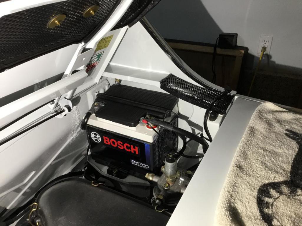

Final iteration with a bit of black vinyl and a fun Bosch decal I found on Ebay.
Looks proper and most wouldn't know I didn't have a Bosch battery in there.
Stealth all the way.....

raynekat   Final iteration with a bit of black vinyl and a fu...   Mar 12 2020, 09:30 PM
FlacaProductions   Slick. Nicely done!!   Mar 12 2020, 09:45 PM
