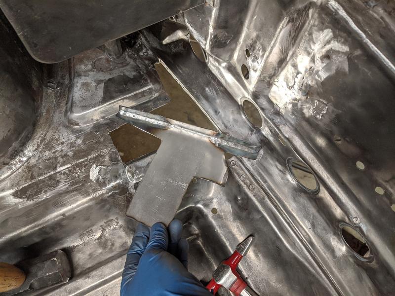

sreyemj   I took a few steps forward and one back. I did we...   Apr 8 2020, 10:53 AM
Superhawk996   Yup, Most people don't believe that these ca...   Apr 8 2020, 12:46 PM
sreyemj   Yup, Most people don't believe that these c...   Apr 8 2020, 09:01 PM

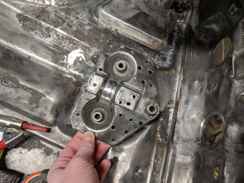

sreyemj   Getting ready to replace the suspension console. I...   Apr 18 2020, 08:50 PM

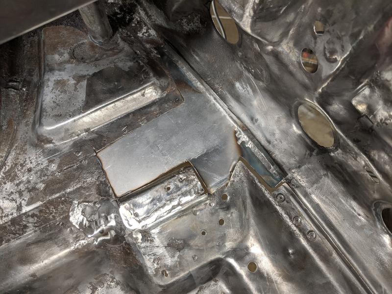

sreyemj   The inside longitudinal behind the engine bar moun...   Apr 18 2020, 09:01 PM

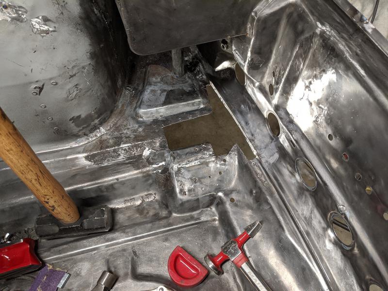

sreyemj   I decided to cut out the piece of the long behind ...   Apr 20 2020, 11:16 PM

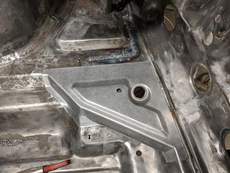

sreyemj   Getting closer, welded the engine bar mount and su...   Apr 21 2020, 09:36 PM
