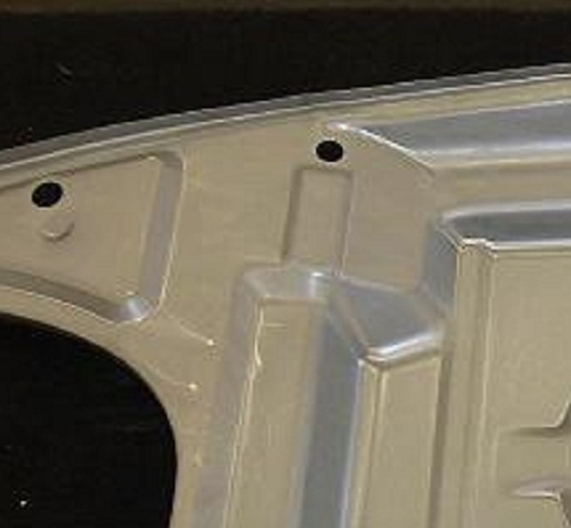

sreyemj   Front trunk patches welded in: http://www.914world...   Feb 15 2020, 08:50 PM
sreyemj   The driver's side front corner was repaired wi...   Feb 15 2020, 09:07 PM
