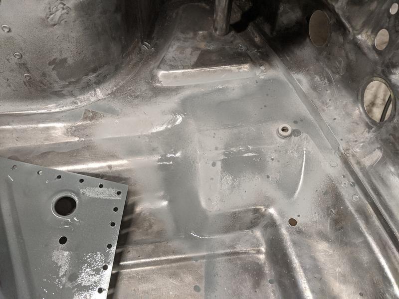

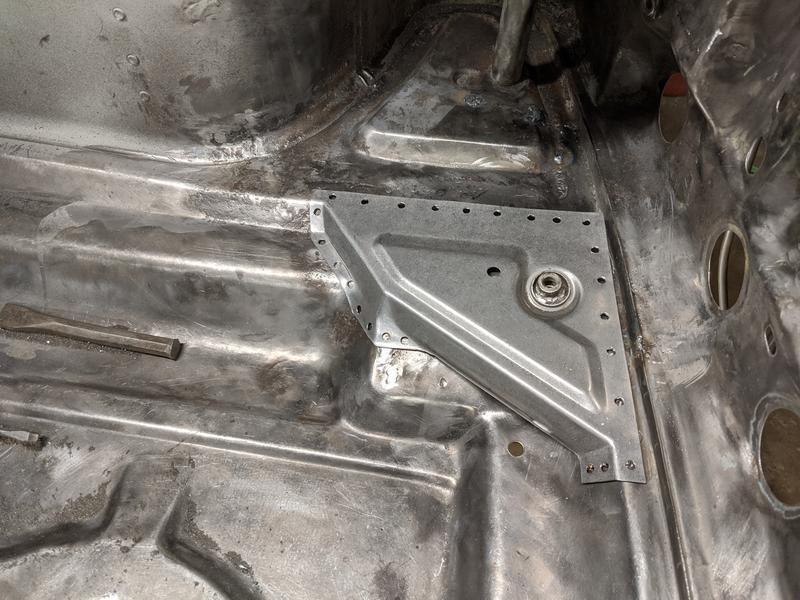

Replacement piece welded in. This would have been much easier with a salvaged piece, fabricating the piece took forever and isn't as clean as I would have liked:

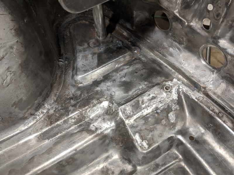

Weld through primer:
(IMG:http://www.914world.com/bbs2/uploads_offsite/i.imgur.com-23821-1584331847.3.jpg)

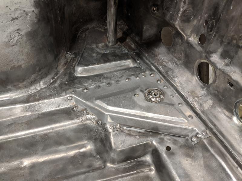

Fortunately this corner reinforcement will cover most of the repair:
(IMG:http://www.914world.com/bbs2/uploads_offsite/i.imgur.com-23821-1584331848.4.jpg)
