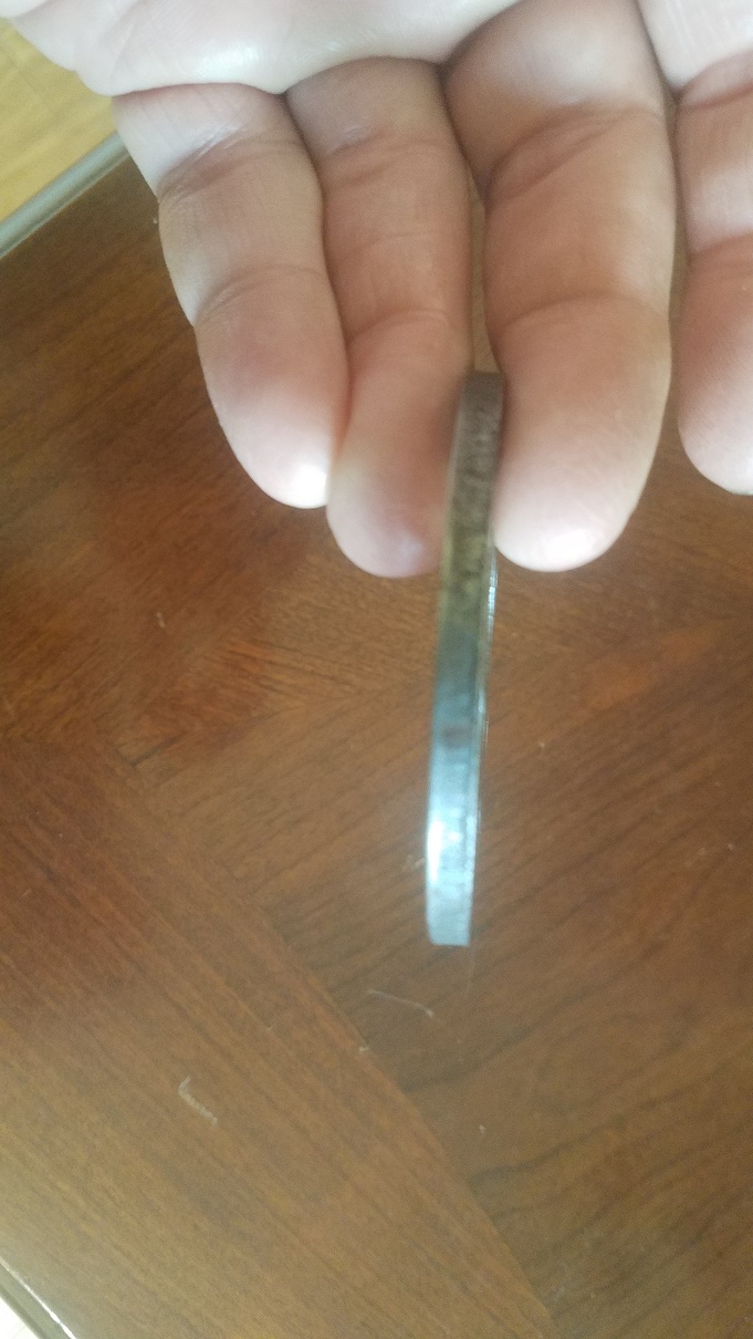

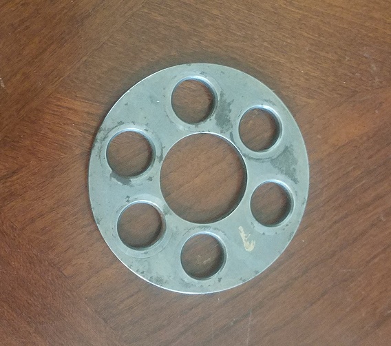

OK, that is what I read elsewhere about bottoming out, I have a 2.7 too. Here is the washer/spacer I was talking about.

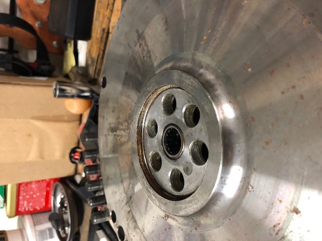

The flywheel side facing the clutch disk has indents for the bolts - so no place for such a washer and in any case placing it there would not change the longitudinal distance from the crankshaft. So not the side for such a washer and also fo much more serious issues.
The flywheel side facing the crank shaft is shown in the pic below. I believe the indent for the crank shaft to fit in is exact and is critically required to center and align the flywheel to the crank. The indent is 4mm deep. So placing a 4mm or even a 3mm washer/spacer in there would be a serious mistake as centering and aligning the flywheel would be compromised. Perhaps you are thinking of the Type 1V set up?

TravisNeff   that distance washer goes on the outside of the fl...   Mar 19 2020, 03:28 PM
TravisNeff   From porsche pet for 74-77 911 Also found the thr...   Mar 19 2020, 03:30 PM
