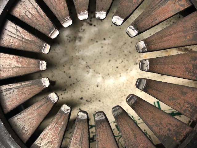

To the brain trust: re slight shudder when engaging the clutch in first gear to begin moving forward.
The clutch assembly is a Sachs brand 228 mm and was installed new about two years ago onto a new flywheel on my 2.7 911 engine, and now has some 5,000 street miles on it. Also new was the throw out bearing (Sachs) and nylon bush under the clutch fork.
I expected to see some clutch disk "burn" deposit on the fly wheel and/or pressure plate. To my surprise, while there were some small deposits on the flywheel and pressure plate, these parts and the clutch disk appear to be in near new condition - little measurable or obvious wear. However, the tips of the pressure plate "fingers (see pic) were worn down where the throw out bearing (TOB) contacts them. This suggests the TOB is slipping on the finger tips causing friction and wear. The TOB feels solid and spins freely like new.
I don't believe this is normal wear. Any thoughts/advice?

Shudder at take off ?
Possible bent throw-out fork or uneven wear where lugs of TOB fit into fork.
TOB also needs to rotate freely on axis of lugs
As mentioned incorrect clutch adjustment.....no free play

SirAndy   This is the part that the throwout bearing is ridi...   Mar 19 2020, 10:09 AM
Root_Werks   This is the part that the throwout bearing is rid...   Mar 19 2020, 11:10 AM

porschetub   Wow that wear looks more like wear after 50,000 mi...   Mar 19 2020, 01:48 PM

GregAmy   That wear is between the pressure plate and the th...   Mar 19 2020, 04:46 PM
914Toy   That wear is between the pressure plate and the t...   Mar 19 2020, 08:49 PM
jcd914   To me the un-even wear on the pressure plate finge...   Mar 19 2020, 10:42 PM

914Toy   Thanks all. Hopefully a new TOB and pressure plate...   Mar 20 2020, 07:59 AM
Steve   Make sure you have a 1/2" free play at the pe...   Mar 20 2020, 08:12 AM
GregAmy   Another consideration is that the throwout bearing...   Mar 20 2020, 08:23 AM

roblav1   Looks typical of clutch cable too tight.   Mar 21 2020, 03:46 PM
914Toy   Completed installing the tranny with new pressure ...   Mar 27 2020, 02:38 PM
