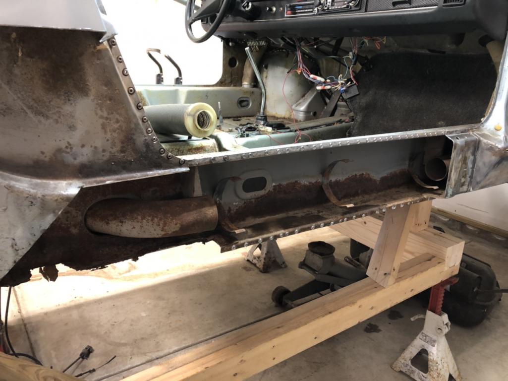

Pulled my rocker covers today to inspect for rot. Unfortunately I found significant rust on both jack points and the driver’s side long has a good size rust hole. I’m going to cut and patch the bad spots in the longs, but I’m trying to avoid a complete resto right now and I don’t want to get into exterior bodywork. The rear fenders are in pretty good shape but they seem to block access to the top flange of the jack point plate. Does anyone know if the jack points can be replaced correctly without cutting out a lower portion of the rear fender?

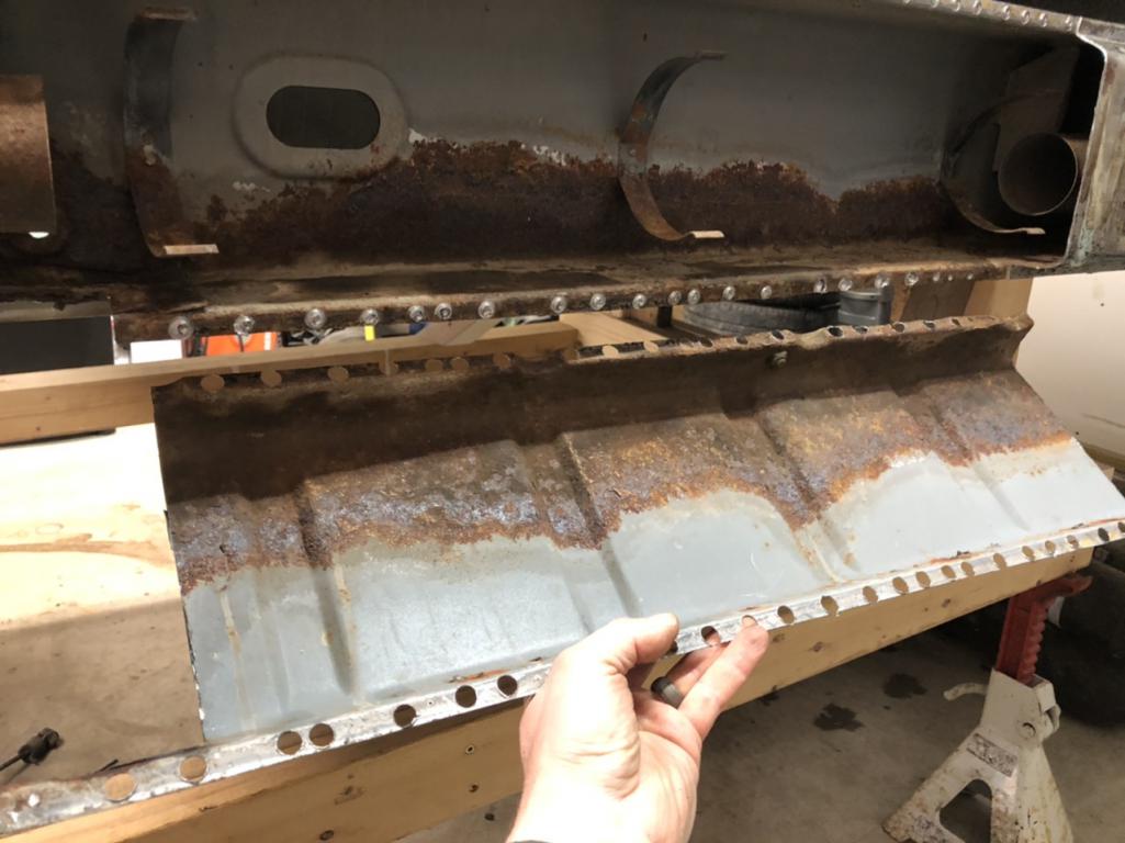

Peeled back some more of the outer long so I could get the heater tube out. Had to quit for the day because I destroyed the last of my HF spot-weld cutters and Amazon hasn’t delivered the rotobroaches that I ordered yet. Most of the inner long seems salvageable except for the section rearward of the seatbelt mount. Amazing how little of this shows through on the exterior of these pieces. These cars really do rust from the inside out. Still trying to decide how many repair panels to buy from RD since I will only need small sections of each piece.

Lilchopshop   So, this happened this week... going full restora...   Mar 19 2020, 06:00 PM

rjames   Hard to tell, but it looks like the jack stands yo...   Mar 20 2020, 10:18 AM

Superhawk996   Yup, that hidden rust at the seat belt anchor coul...   Mar 22 2020, 07:46 AM
