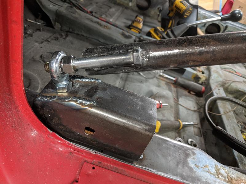

sreyemj   I removed the interior so I could weld my door bra...   Mar 30 2020, 10:47 PM
