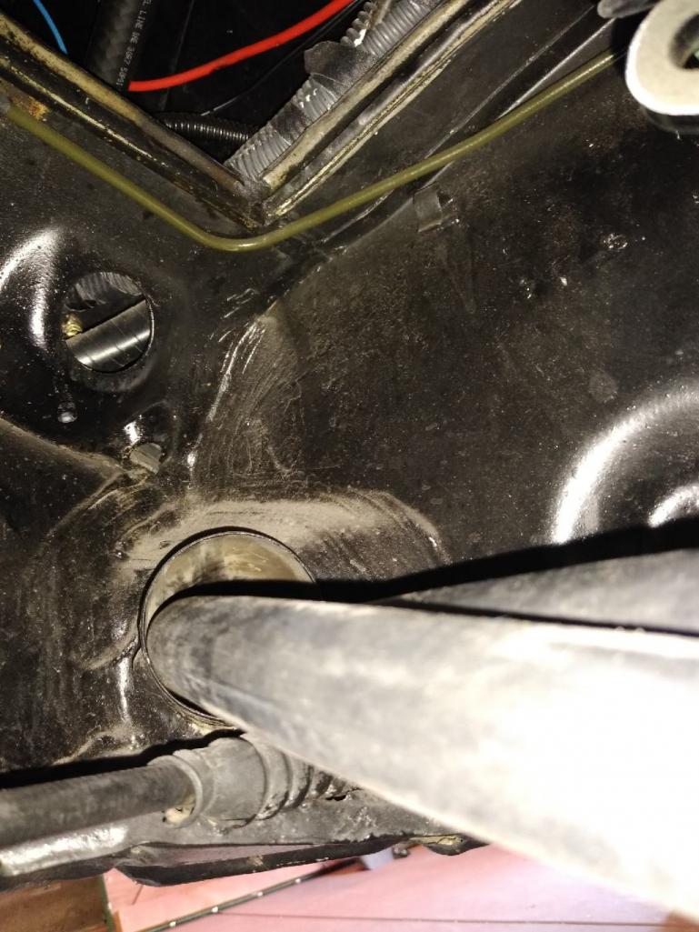

I got alittle more done tonight routing the suction and discharge hose through the driver long. The larger suction hose is going to enter the cabin on the horizontal shelf behind the gas tank; directly above the evap. The discharge hose is going behind the tank, down and under it out the front bulk head to the condenser.
Putting fittings on this under the car will be a pain in the ass.

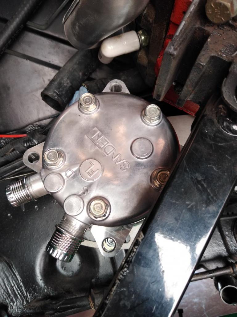

Unfortunately this side exit head on the compressor isn't going to work. Sanden recommends not rotating the fittings past 90 degrees. Tempted as I am to try it my guess is oil will pour out when I install the fittings, or may make the vacuum and fill process difficult. Rotating it 90 degrees clockwise points the fittings right at the exhaust. I decided to swap out the head for a rear exit setup which should put the fittings in a better place.
