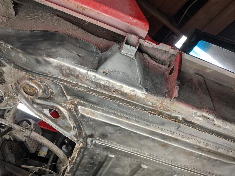

(IMG:http://www.914world.com/bbs2/uploads_offsite/i.imgur.com-23821-1581113672.2.jpg)
Passenger long, looks fairly solid from the outside. The hole is where I used a cheap endoscope to look at the inside (lots of rust).

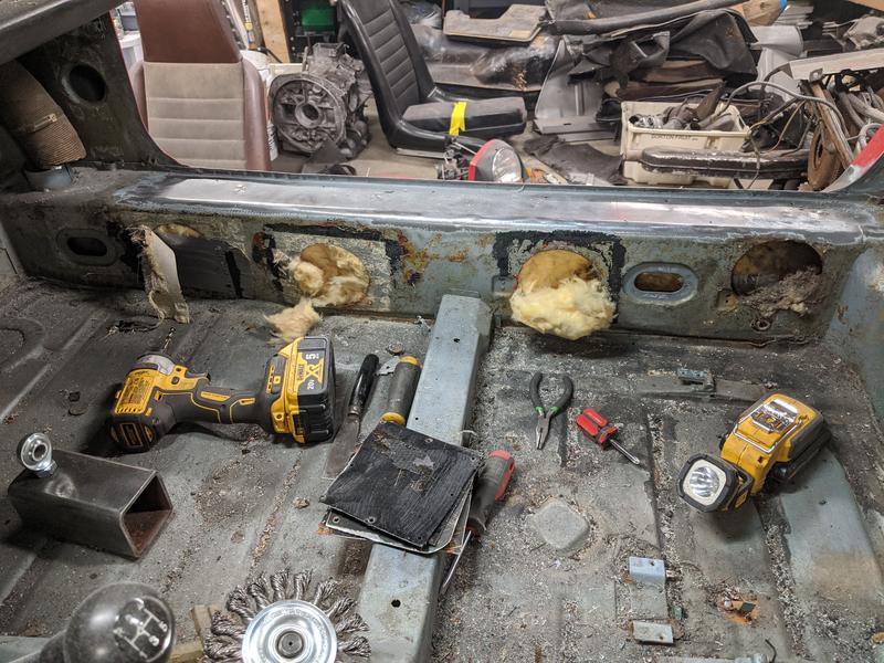

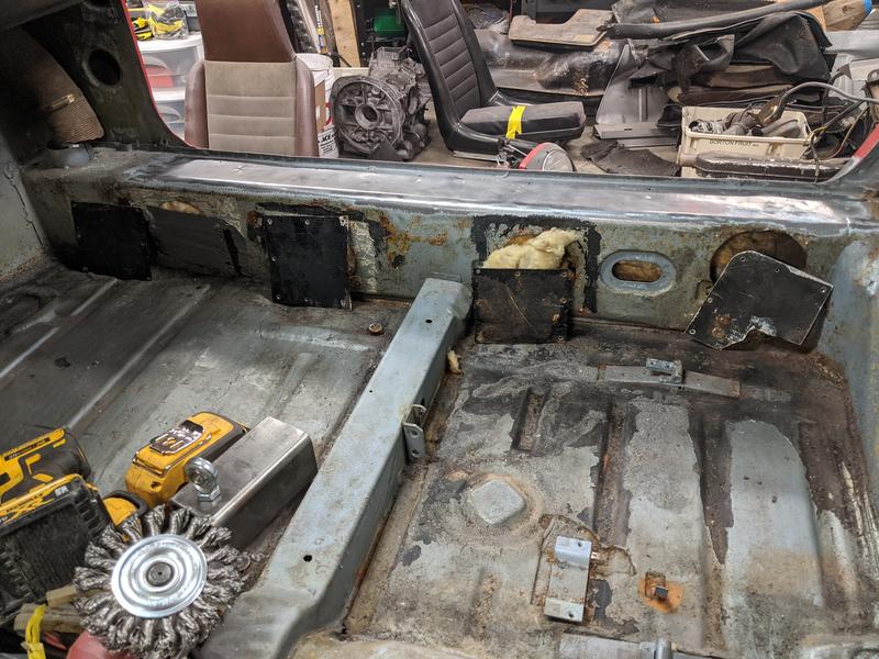

I removed the interior so I could weld my door braces on, and made an interesting discovery. It looks like someone has cut into the inside long and stuffed it full of fiberglass insulation? There are aluminum covers pop-riveted over the large round holes as well as duct tape and some duct tape inside the long on the heating tube.
Trying to decide what to do with this. I can access the inside of the long from these holes and probably knock off most of the rust with a die grinder. I was going to use the 914 LTD reinforcement kit (already purchased), but the inner long reinforcement kit would cover this area nicely. I'm also curious if treating this rust inside the long with Ospho would be sufficient. The outside looks ok, and I'm not sure I'll gain much by opening it up.
The metal covers:
(IMG:http://www.914world.com/bbs2/uploads_offsite/i.imgur.com-23821-1585630037.1.jpg)
The holes and insulation:
(IMG:http://www.914world.com/bbs2/uploads_offsite/i.imgur.com-23821-1585630193.1.jpg)

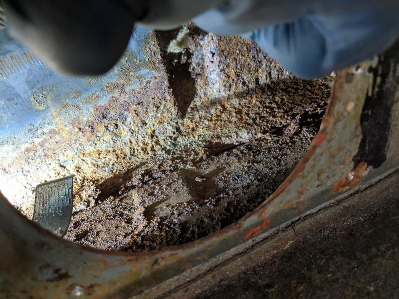

Loose rust inside the long, doesn't look too bad:
(IMG:http://www.914world.com/bbs2/uploads_offsite/i.imgur.com-23821-1585630038.3.jpg)
