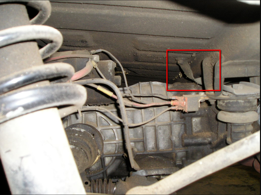

When it's acting up, if you test the yellow wire at the starter while someone turns the key to the start position, is there voltage at the terminal where the yellow wire plugs into the starter? Alternatively, if you hook up a piece of wire directly to the battery positive terminal, and touch it to the yellow wire terminal on the starter, does the starter turn?
The starter wire, depending on the year, has multiple points of failure that should be checked before condemning the starter.
As you mentioned, the ignition switch may be bad. That's where the starter signal originates from, that's one spot to check.
(Only on models with the seatbelt interlock: Under the passenger seat there's a relay that goes bad and prevents the starter signal from passing through it, that needs to be bypassed, that's a spot to check.)
The signal then passes through the engine relay board, the signal goes in the 14 pin connector at the front of the board, and exits the 12 pin connector at the rear. Both connectors are possible spots for a bad connection.
Finally from there it goes through the engine tin and down to the starter.
All of those connections are potential intermittent connections that need to be checked, cleaned up, or otherwise addressed.
And as 914-300Hemi mentioned, check the transmission ground strap connection. If the ground strap isn't connected, or the connection is corroded, loose, etc. then you'll be plagued with starter (and many other) issues! The transmission ground strap is a flat, braided cable located at the top of the transmission tail housing, and connects between the transmission and a stud on the underside of the rear trunk floor.
Edit: Grabbed an image from this post http://www.914world.com/bbs2/index.php?sho...p;#entry1306436
The strap you'll be looking for I've drawn a Red Square ™ around.
(IMG:http://www.914world.com/bbs2/uploads_offsite/i.imgur.com-18880-1585870115.1.png)
