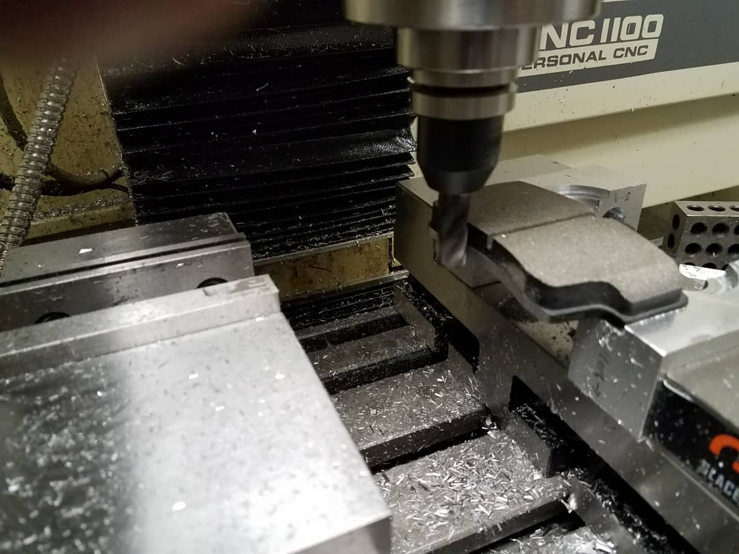

So I understand there supposed to be some trimming of the rear pads on the bottom potion.
When I mock up the pad I've already milled on, it looks like I need to go another .100" to .125" more.
Did I mess up the install?
Top pad is modified, bottom stock.

Used my mill at home.

roblav1   I just went through this a couple weeks ago. Yes,...   Apr 2 2020, 05:14 PM
Luke M   Yes, the pads need to be trimmed at the bottom to ...   Apr 2 2020, 06:24 PM
Mueller   Yes, the pads need to be trimmed at the bottom to...   Apr 2 2020, 06:39 PM
jim_hoyland   What did you use to modify the pads ? http://www....   Apr 2 2020, 06:54 PM
Mueller   Used my mill at home.   Apr 2 2020, 08:07 PM

roblav1   I did mine on a bench grinder. Just like I did on...   Apr 2 2020, 10:26 PM
jd74914   I did mine on a bench grinder. Just like I did o...   Apr 3 2020, 07:12 AM
