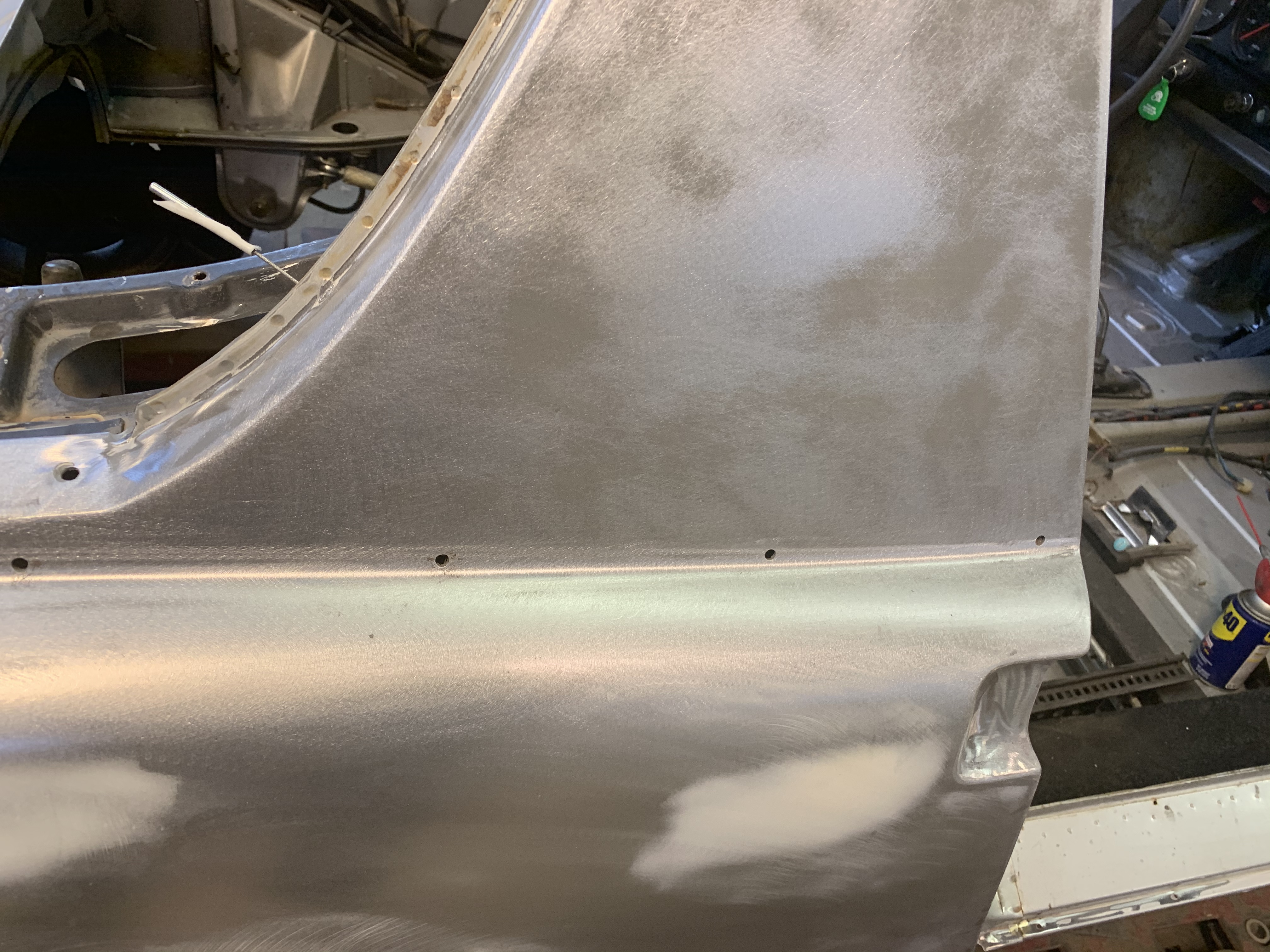

draganc   Found a competent and trustworthy body/paint shop ...   Mar 31 2020, 08:52 PM
draganc   PS: went down to bare metal to be positively surpr...   Mar 31 2020, 08:53 PM
draganc   ...   Mar 31 2020, 09:02 PM
Cairo94507   Nice looking metal. :beer2:   Apr 1 2020, 09:12 AM
