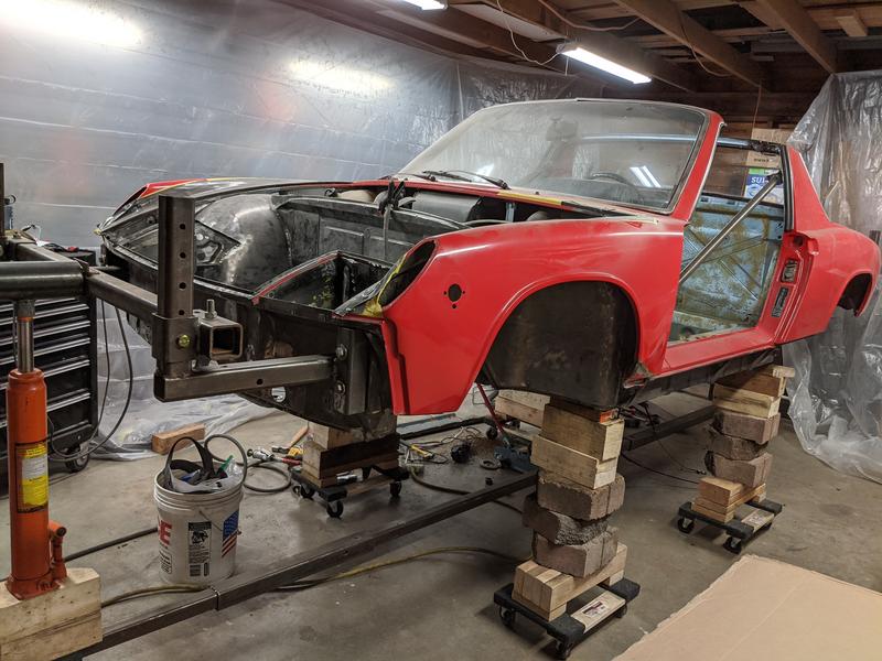

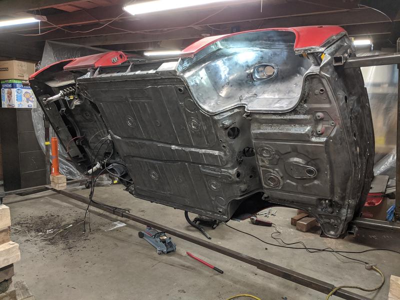

Car is on a rotisserie now, planning to cut into the long tomorrow. I'm thinking I'll start by reinforcing the inner long from the inside of the car because I'm worried the car will distort if I cut the outer long with the inner long weakened as much as it is. The other option would be settling it on the jack points and then cutting into it. Anyone have any insight on this?

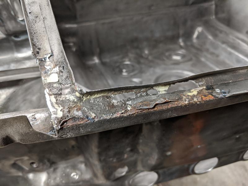

I also took a crack at repairing the nasty front trunk seal channel with some steel and a harbor freight bending brake:

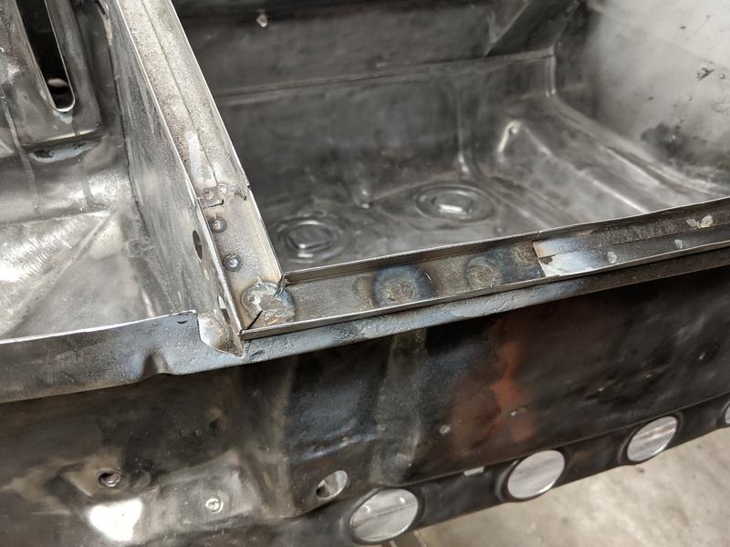

Better:

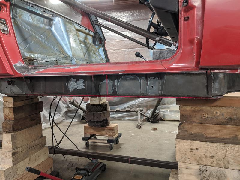

I used the rotisserie to lower the car on to the four jack points and then checked with a laser level to ensure everything was level (see laser near bottom of long in the picture). Door gaps were not far off, and adjusted nicely with the door braces.

QUOTE(sreyemj @ Apr 2 2020, 04:03 PM) *
(IMG:http://www.914world.com/bbs2/uploads_offsite/i.imgur.com-23821-1585861475.1.jpg)
You are brave. Be careful if you lean up against your car with any weight in your hands!! Yikes.

QUOTE(Costa05 @ Apr 3 2020, 11:22 PM) *
It's still supported by the rotisserie, the blocks are there to keep it flat.
