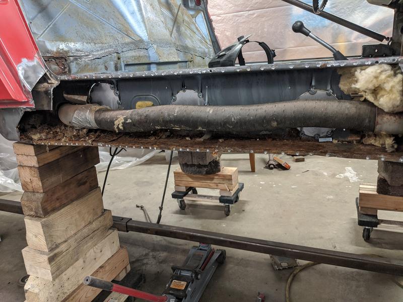

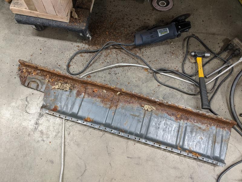

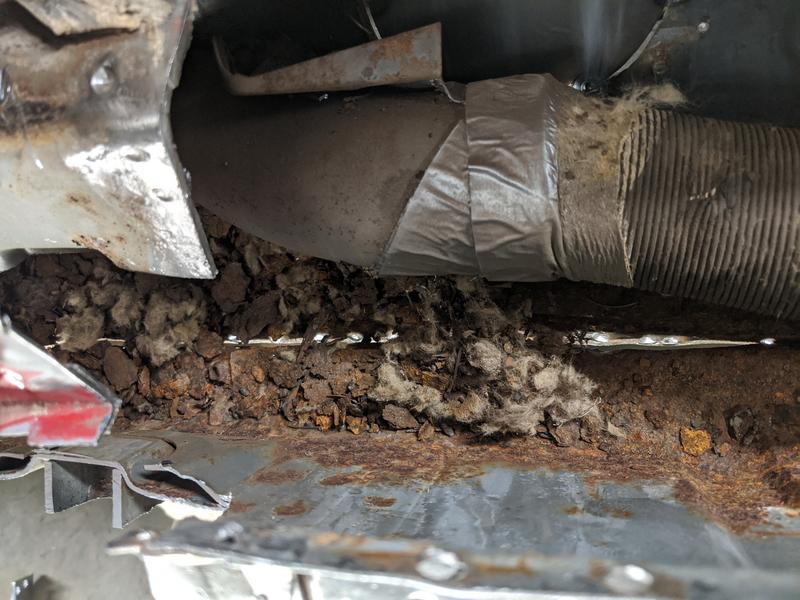

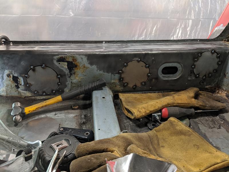

Finally opened up the longitudinal. I tacked some plugs on the inside long to help stiffen it before I cut into the outside. Rust actually doesn't seem that bad compared to some that I've seen.
I also found some mouse droppings so it may be that the insulation was part of a mouse nest. The duct tape was probably the PO's attempt to clean up the mouse nest. Hopefully the heater tube is usable, replacements look expensive.
The plugs:
(IMG:http://www.914world.com/bbs2/uploads_offsite/i.imgur.com-23821-1585976103.1.jpg)
Outer:
(IMG:http://www.914world.com/bbs2/uploads_offsite/i.imgur.com-23821-1585976104.2.jpg)
Inner:
(IMG:http://www.914world.com/bbs2/uploads_offsite/i.imgur.com-23821-1585976104.3.jpg)
Prior owner's duct tape and some mouse droppings:
(IMG:http://www.914world.com/bbs2/uploads_offsite/i.imgur.com-23821-1585976104.4.jpg)

bbrock   Unfortunately, that heater hose isn't the orig...   Apr 4 2020, 08:31 AM
doug_b_928   The duct tape was to hold the tube on because it...   Apr 4 2020, 08:32 AM
doug_b_928   You beat me to it, Brent.   Apr 4 2020, 08:33 AM
sreyemj   Ah, makes sense. I guess I'm looking for a re...   Apr 4 2020, 09:41 AM
bbrock   Well, it isn't the first time someone's be...   Apr 4 2020, 11:24 AM
sixnotfour   Well, it isn't the first time someone's b...   Apr 4 2020, 11:49 AM
