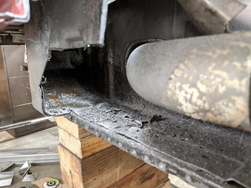

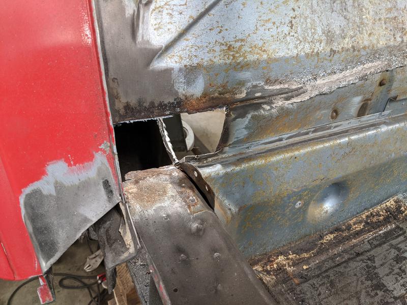

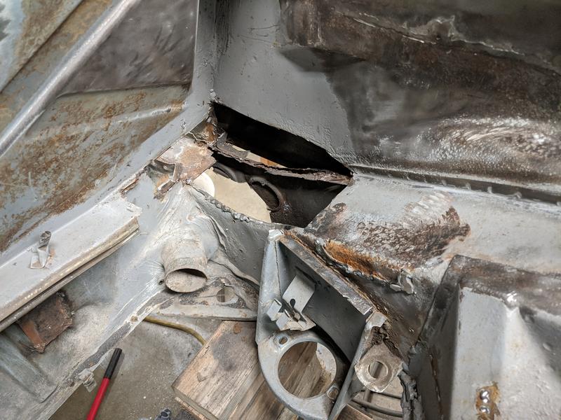

Done with most of the cutting. I had to back off my passenger door brace slightly as the gap had widened by about 1/16in after removing all this metal. There are areas of the removed metal that are made of two laminated pieces of steel (including the top of the long in the engine compartment. It would be nice to reproduce the factory configuration, but I will probably use 16ga steel for the structural parts of the long repair.
From inside the passenger area:
(IMG:http://www.914world.com/bbs2/uploads_offsite/i.imgur.com-23821-1586065007.1.jpg)
Inside the long, dark from the ospho:
(IMG:http://www.914world.com/bbs2/uploads_offsite/i.imgur.com-23821-1586065008.2.jpg)

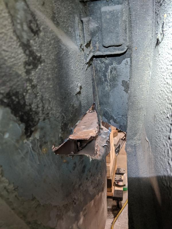

From inside the rear fender:
(IMG:http://www.914world.com/bbs2/uploads_offsite/i.imgur.com-23821-1586065008.4.jpg)

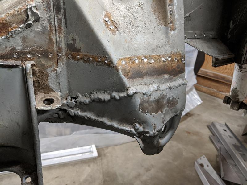

The rear suspension console has some welded repairs. This will be replaced after the long repair so I removed the engine shelf on the passenger side:
(IMG:http://www.914world.com/bbs2/uploads_offsite/i.imgur.com-23821-1586065008.5.jpg)
(IMG:style_emoticons/default/headbang.gif) Scary stuff. I found braze in my suspension console.
Rant for previous abusers of these vehicles:
People -- this is the part that holds the wheel on the car for crying out loud. Were you really willing to trust your lives to that rusted metal and pooly welded (or brazed in my case) backyard fix? (IMG:style_emoticons/default/shades.gif)
OK - Done now.
Oh my! (IMG:style_emoticons/default/unsure.gif) (IMG:style_emoticons/default/yikes.gif)
