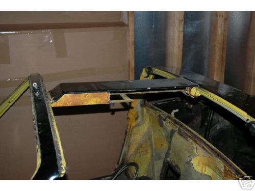

Mike,
Don't have historical data on the 916 but I plan to use engman's lower bracing if I don't use a cage. Here's a hack solution! (IMG:style_emoticons/default/laugh.gif)
Felix

GWN7   I saw this on one car. Don't know how function...   Dec 12 2004, 11:45 AM
neo914-6   :lol: :lol: :lol: And this is on an original 91...   Dec 12 2004, 11:47 AM
