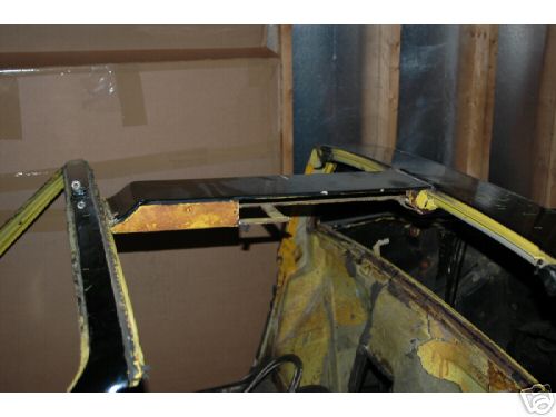

I saw this on one car. Don't know how functional it would be.

neo914-6   :lol: :lol: :lol: And this is on an original 91...   Dec 12 2004, 11:47 AM
