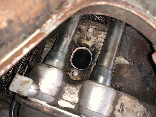

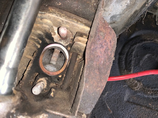

I took the exhaust apart because of leaks, here are two pictures of Cylinder 3 and Cylinder 4 exhaust ports
Cylinder 3
And Cylinder 4
Seems that 3 is running a bit lean and that 4 is running a bit rich. Also, do the colors on the copper gaskets (new, ran them perhaps 2-3 hours) indicate that they are leaking?

Boy now there is a "shelter in place" project waiting to get done. That oil cooler looks plugged and so much dirt on the heads. Drop the engine and tranny and take it apart to clean up everything so it runs cooler as its a air cooled engine.
