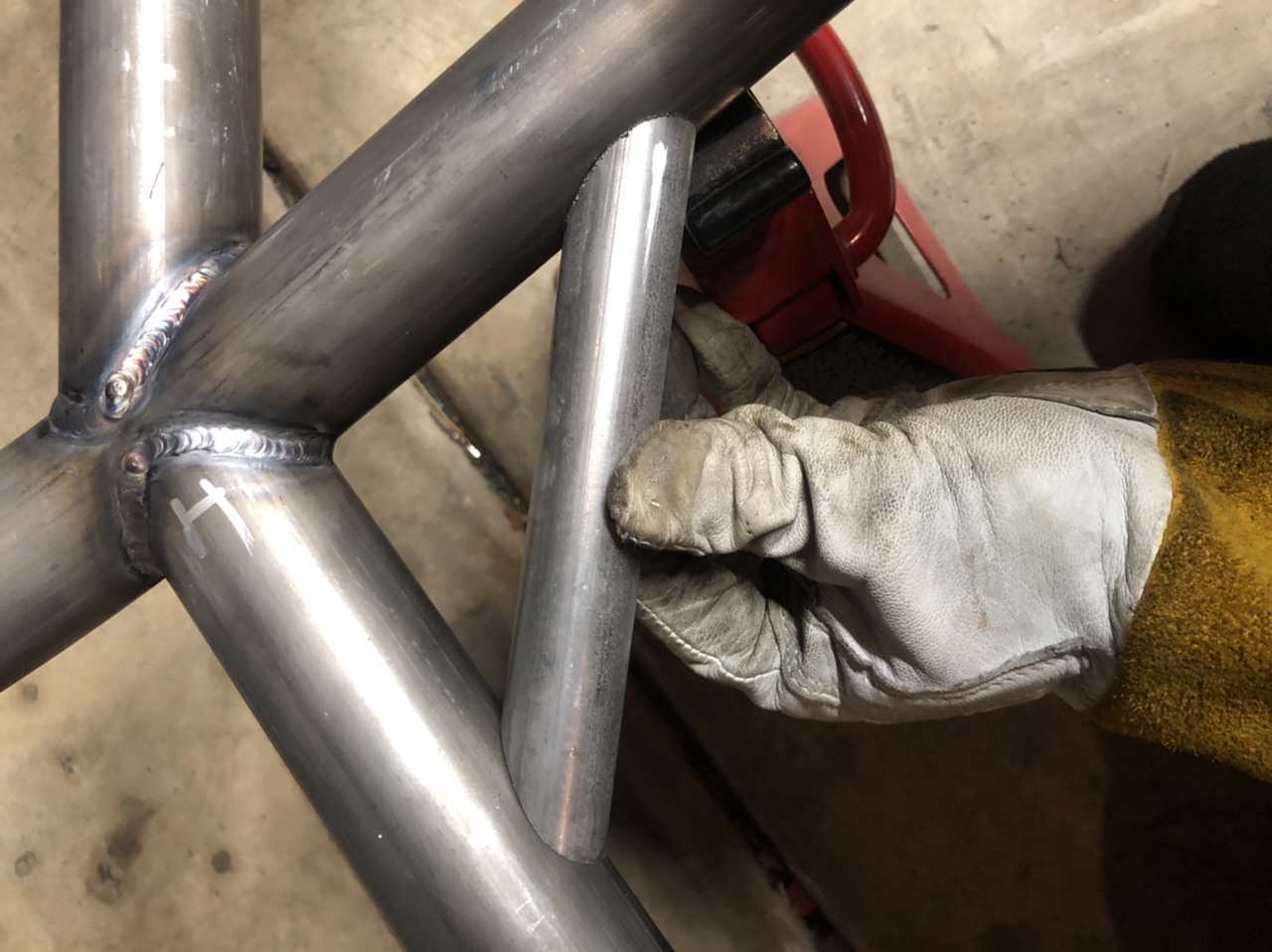

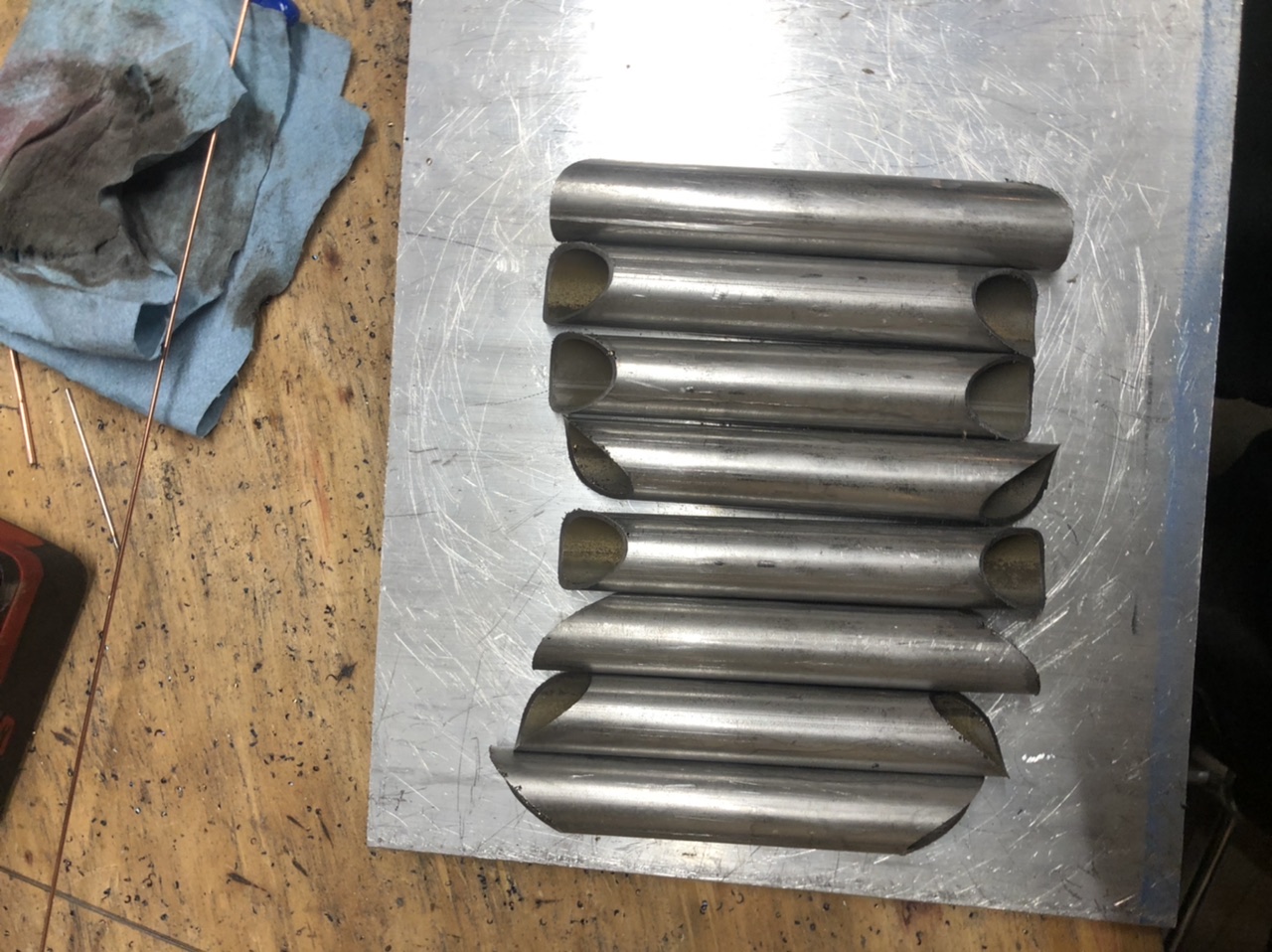

Built a lot of gussets, i really badly wanted them to sit flush with the bottom of the floor but after an hour and a half of trial and error, i found it cannot be done on 90 degree joints with my tube notcher as is. I wanted the gussets to double as mounts to the floor pan but ill have to fab up separate mounts for that (IMG:style_emoticons/default/confused24.gif) They gussets fit pretty good and i made all 8 in 30 minutes after that whole debacle. Now to weld in!

tazz9924   Spent the day adding in the wings of the chassis u...   Apr 6 2020, 09:03 PM

tazz9924   Built a lot of gussets, i really badly wanted them...   Apr 7 2020, 08:53 PM
