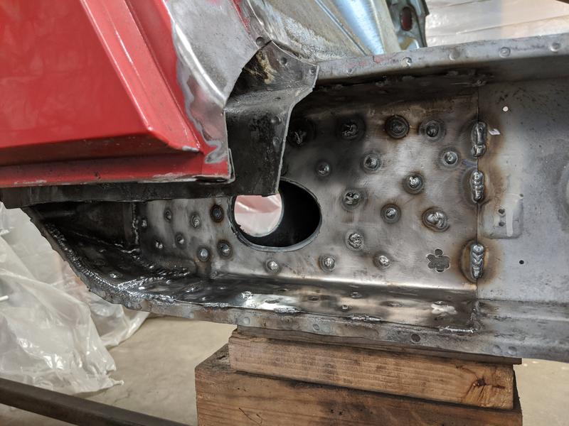

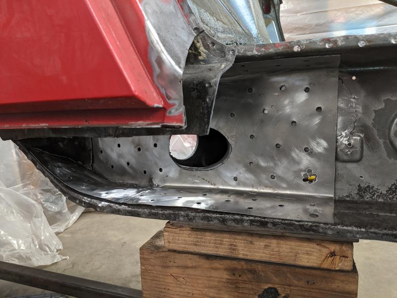

For sure, this one had just a few pin holes and they were painted over. I'll probably stick an endoscope into the other long (driver's side) just to check for rust. No way ANY 914 is rust free unless you've made it that way.
New inner lamination, butts up to and will be welded to clean metal:
(IMG:http://www.914world.com/bbs2/uploads_offsite/i.imgur.com-23821-1586401267.1.jpg)
Welded in:
(IMG:http://www.914world.com/bbs2/uploads_offsite/i.imgur.com-23821-1586401481.1.jpg)
