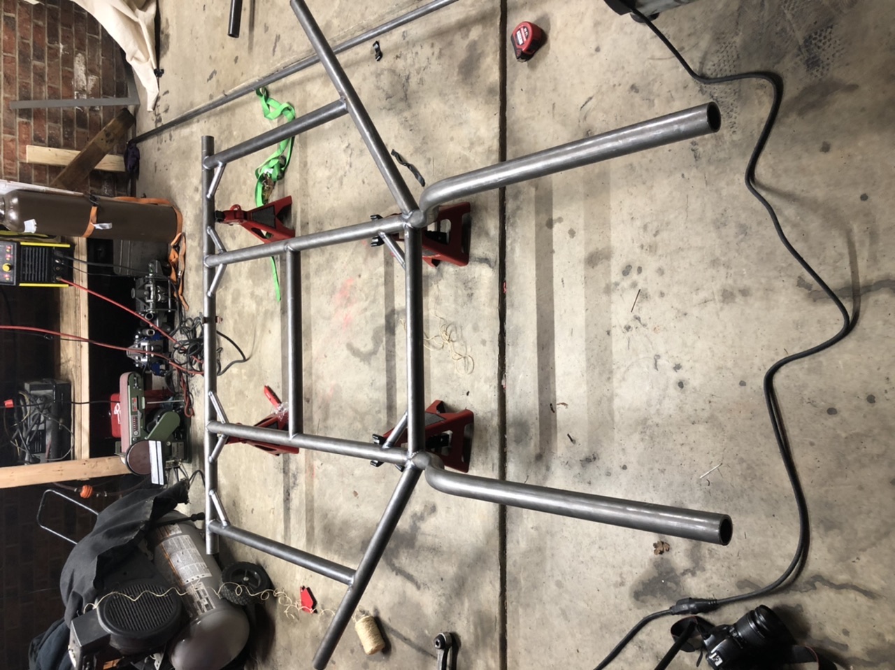

Not a big day but got some of the gussets added in. I also added the middle bar back into the floor now that i know where center is.
