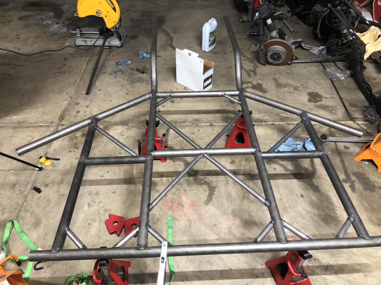

I have one word of advice: Triangulation.
tazz9924
post Apr 9 2020, 06:18 PM
Posts: 755
Joined: 31-May 15
From: Mooresville NC
Member No.: 18,779
QUOTE(URY914 @ Apr 9 2020, 03:56 PM) *
Ahh but it is the word of the day with the new additions to the floor!Attached Image
