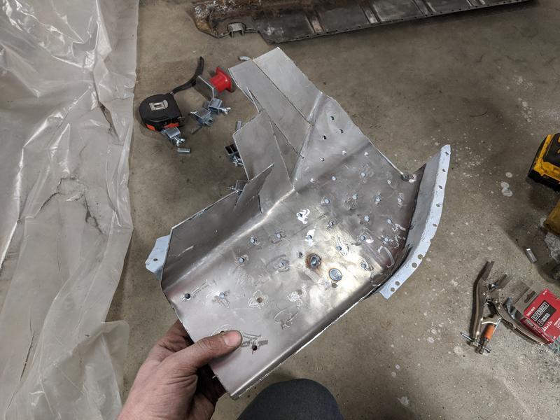

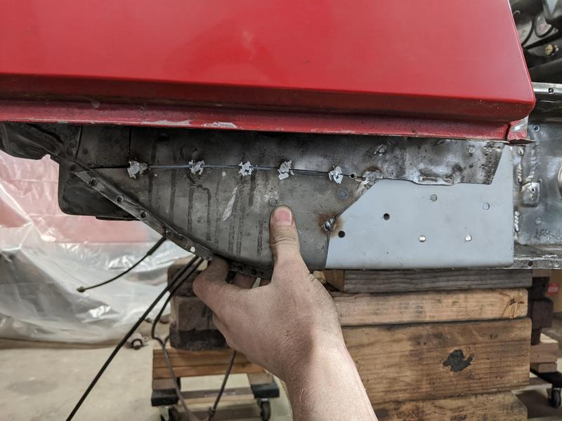

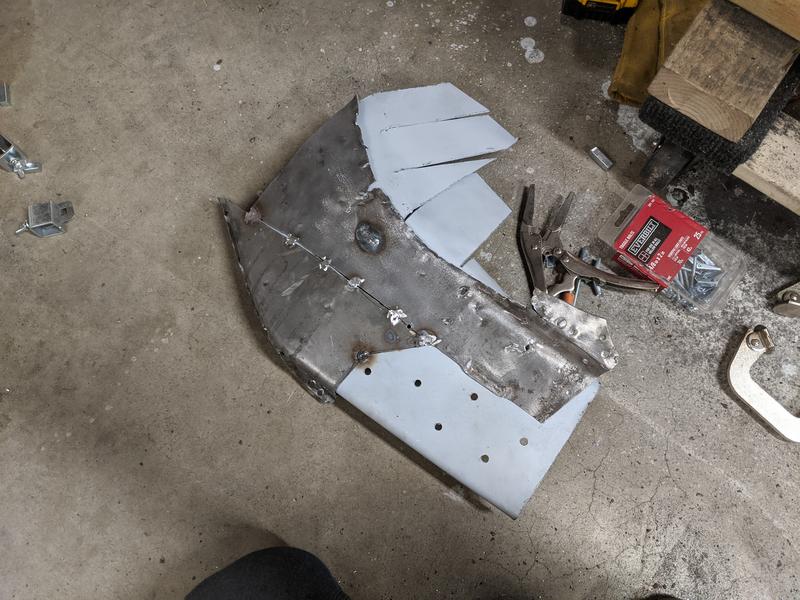

Fabricating the piece for the outer long. Not sure why people say the outer long is the main source of strength?
(IMG:http://www.914world.com/bbs2/uploads_offsite/i.imgur.com-23821-1586551156.1.jpg)
(IMG:http://www.914world.com/bbs2/uploads_offsite/i.imgur.com-23821-1586551157.2.jpg)
(IMG:http://www.914world.com/bbs2/uploads_offsite/i.imgur.com-23821-1586551157.3.jpg)
