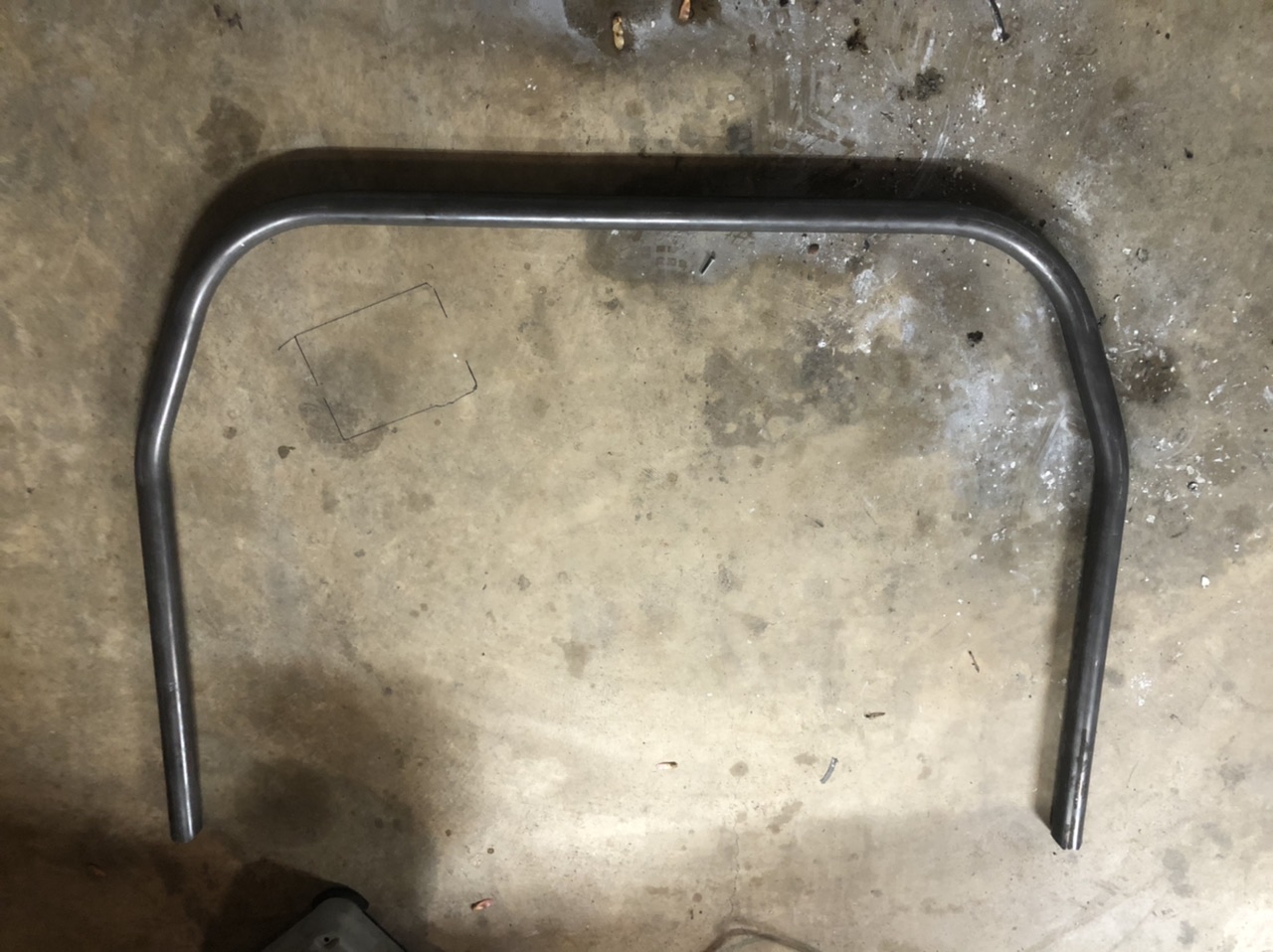

Got the last of the welding that is possible on my current tig cup, i was gonna get the right cup today but it was damn good friday. The last of the tight welds will wait till monday. I also finally got the main hoop bent and notched. It still needs a little work to get it right because its a little wide. i may tighten a couple bends a degree or so to bring it next to perfect. Nothing serious. But it’ll wait till tomorrow like the dash bar

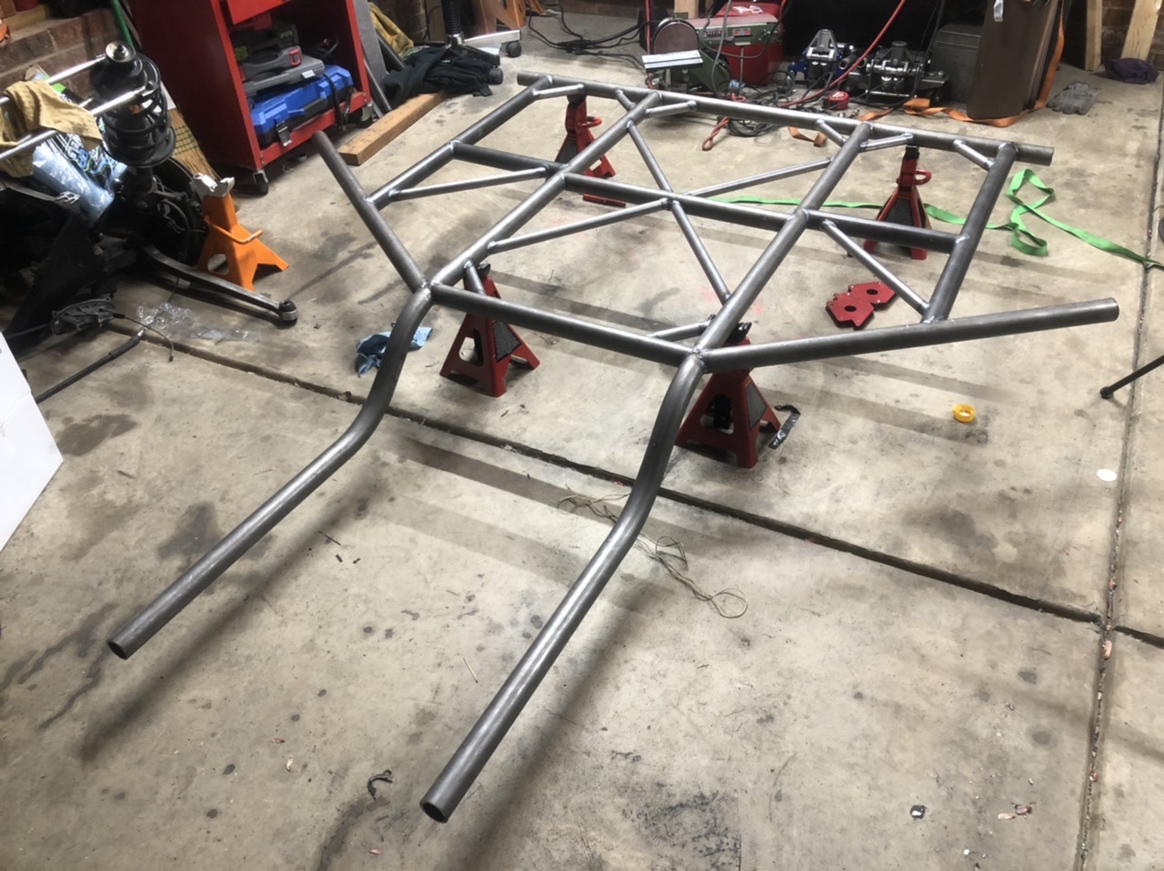

tazz9924   Spent the day adding in the wings of the chassis u...   Apr 6 2020, 09:03 PM
Mueller   Looks great so far. Have you measured the floor j...   Apr 7 2020, 08:46 AM
tazz9924   Looks great so far. Have you measured the floor ...   Apr 7 2020, 05:59 PM
rgalla9146   Looks great so far. Have you measured the floor...   Apr 7 2020, 06:27 PM
Andyrew   Flat and straight enough is flat and straight enou...   Apr 7 2020, 07:47 PM
tazz9924   Flat and straight enough is flat and straight eno...   Apr 7 2020, 08:48 PM

URY914   I have one word of advice: Triangulation.   Apr 9 2020, 05:56 PM
tazz9924   I have one word of advice: Triangulation. Ahh b...   Apr 9 2020, 06:18 PM

tazz9924   Finally building in 3d, got the main hoop finish n...   Apr 11 2020, 09:42 PM
