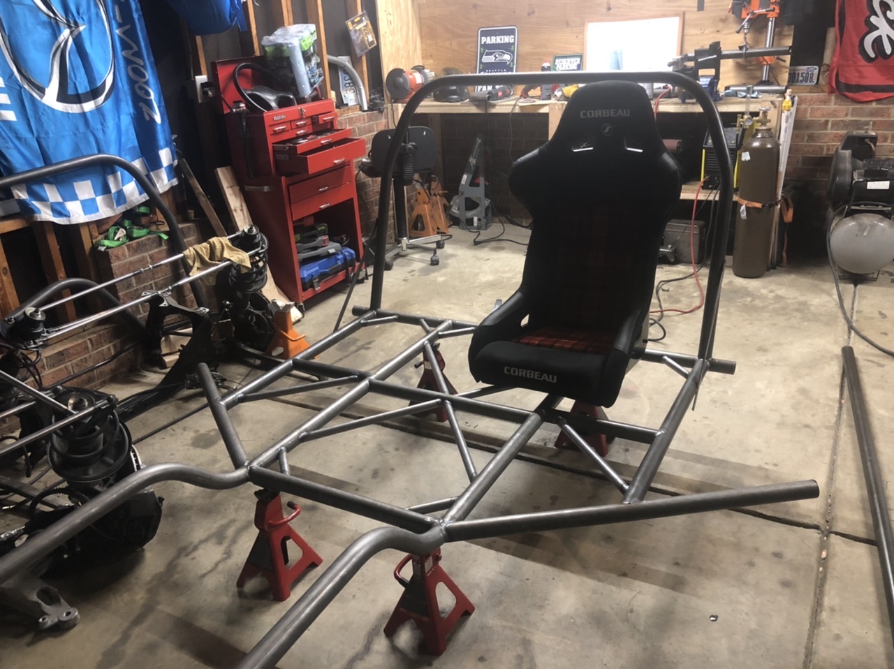

Finally building in 3d, got the main hoop finish notched and welded on!

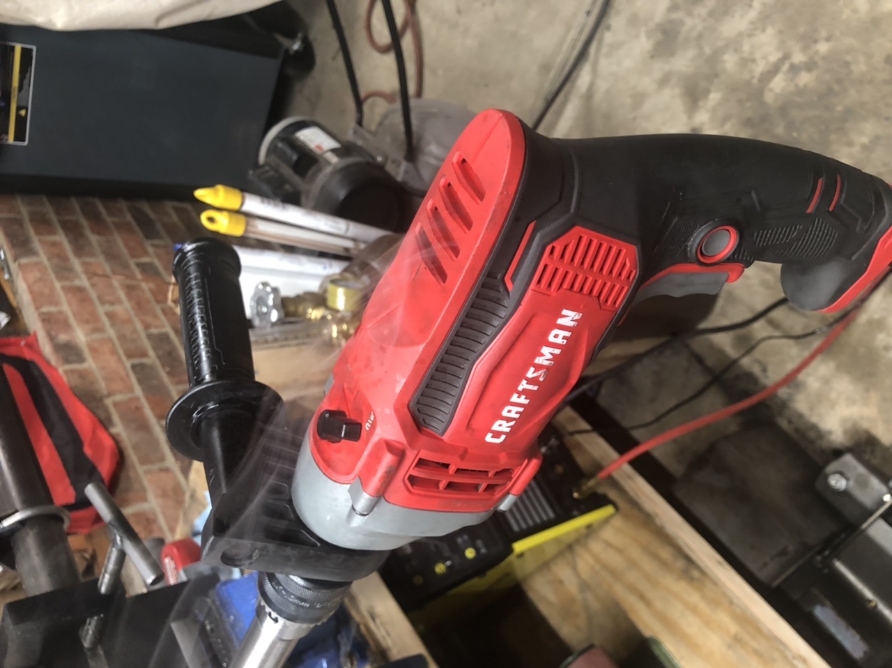

Killed the drill finally, i was trying to notch dash bars... Craftsman Warranty..?

maf914   Craftsman warranty? Good luck with that. What wa...   Apr 12 2020, 06:55 AM
ClayPerrine   Craftsman warranty? Good luck with that. What w...   Apr 12 2020, 07:36 AM
Andyrew   I hear Ace and Lowe's still exchange them. Cra...   Apr 12 2020, 08:37 AM
