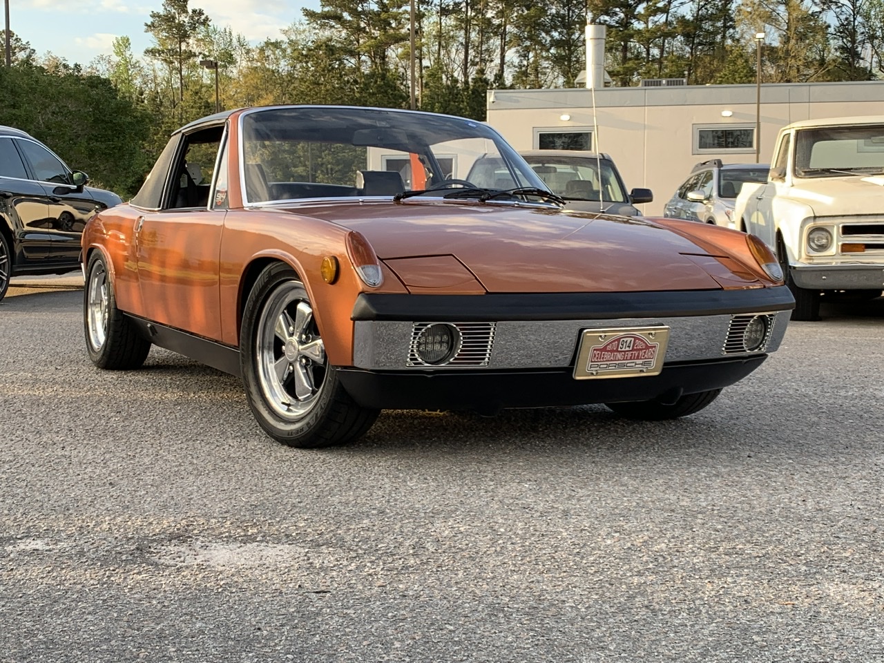

When I decided to backdate my bumpers, I wanted to have all of the answers before I started cutting stuff off and drilling holes. Using the fine search function, I was able to find all of those answers, but I had to wade through many, many threads to get them all.
With that in mind, I decided to write one up that will contain every last bit of information needed to do the job. I can’t take credit for much, if any, if any of the information below. I got most all of it from my searches, and I will try to give credit where credit is due. I apologize up front for the crappy phone pictures – while bad, they still tell the story.
While there are a few of us who like the looks of the late bumper (myself included, depending on the color of the car), there is one really good reason to go with early bumpers – weight. I have seen many figures thrown about, so I decided to weigh them both, including all mounting hardware, fog lights, grills, etc. I was quite surprised at just how much heavier the later bumpers are.
Front:
Early – 20 pounds, included pad, dog bones, lights, grills, and hardware
Late – 46 pounds, including the shocks, and hardware (non fog light bumper)
Rear:
Early – 18 pounds, including pad, dog bones and hardware
Late – 50 pounds, including the shocks, and hardware
38 pounds vs. 96 – 58 pounds, or roughly 3% of the entire weight of the car removed from the two places you would most want to lose it!
