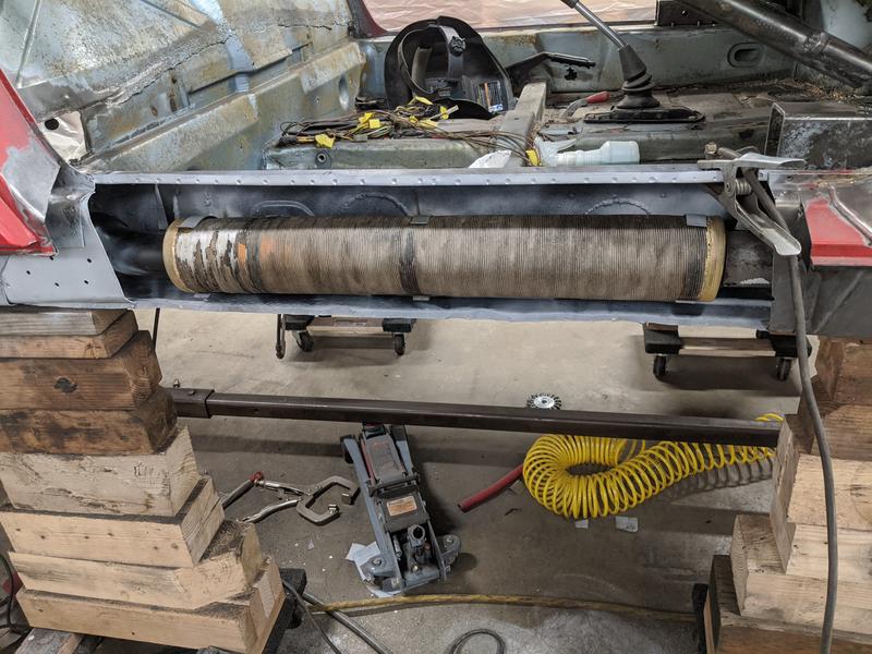

Installed the heater tube from 914werke.com:
(IMG:http://www.914world.com/bbs2/uploads_offsite/i.imgur.com-23821-1586844245.1.jpg)

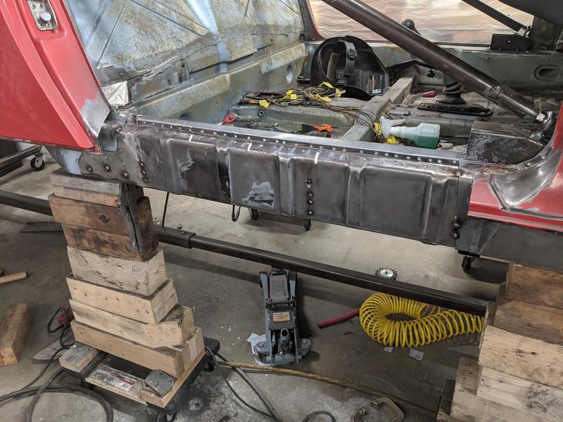

Starting to weld the outer long:
(IMG:http://www.914world.com/bbs2/uploads_offsite/i.imgur.com-23821-1586844246.2.jpg)

sreyemj   Finally opened up the longitudinal. I tacked some...   Apr 3 2020, 10:55 PM
bbrock   Unfortunately, that heater hose isn't the orig...   Apr 4 2020, 08:31 AM
doug_b_928   The duct tape was to hold the tube on because it...   Apr 4 2020, 08:32 AM
doug_b_928   You beat me to it, Brent.   Apr 4 2020, 08:33 AM
sreyemj   Ah, makes sense. I guess I'm looking for a re...   Apr 4 2020, 09:41 AM
bbrock   Well, it isn't the first time someone's be...   Apr 4 2020, 11:24 AM

sreyemj   Fabricating the piece for the outer long. Not sur...   Apr 10 2020, 02:39 PM

sreyemj   Getting closer, welded the engine bar mount and su...   Apr 21 2020, 09:36 PM
sreyemj   Finished some minor weld grinding and started rebu...   Apr 22 2020, 11:59 PM
sreyemj   Reattached the passenger door sill and repaired th...   Apr 24 2020, 09:57 AM
