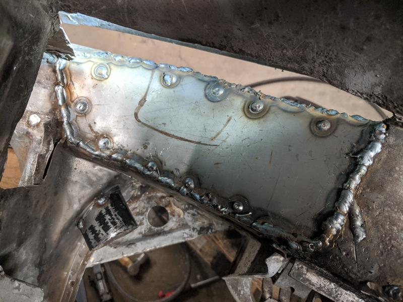

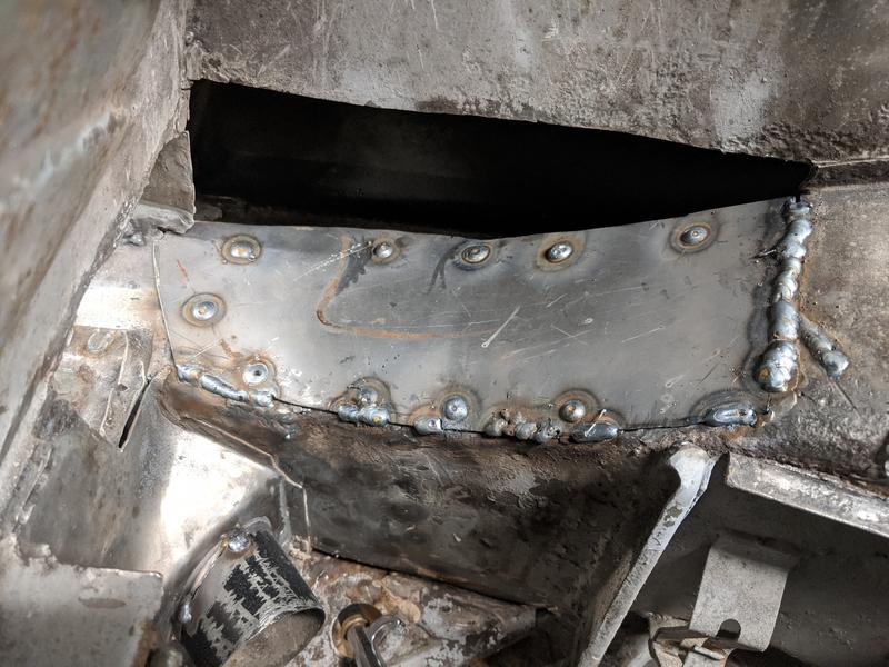

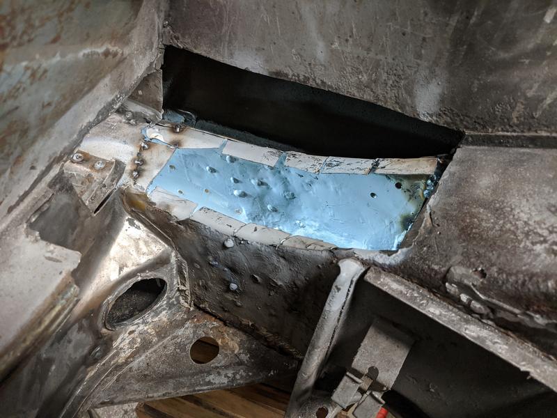

I'm going to put the 914LTD kit on this, but I wanted the area to be as close to origional strength as possible.
After closing up the outer long, I put the final patch over the hell hole area. I used my inner layer (the new metal) to make tabs along the edge and then plug welded the new piece to the tabs. After that, I was able to hammer down the edges and weld the seams. The welds look scrappy because I was only doing short sections (and cooling with compressed air), but I'm really happy with how it welded up. On the rotisserie afterward, the car is MUCH stiffer.
(IMG:http://www.914world.com/bbs2/uploads_offsite/i.imgur.com-23821-1586922550.1.jpg)
(IMG:http://www.914world.com/bbs2/uploads_offsite/i.imgur.com-23821-1586922550.2.jpg)
(IMG:http://www.914world.com/bbs2/uploads_offsite/i.imgur.com-23821-1586922550.3.jpg)
