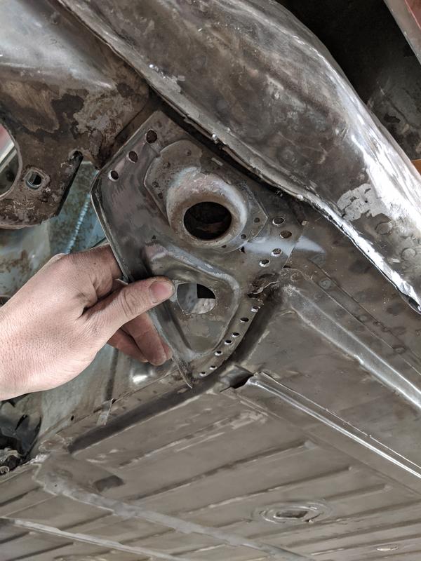

More grinding away, literally. Removed the passenger jack mount, it will be replaced. I think the mount for the engine bar might be compromised too, at least there is rust behind it. I'm going to remove it and see how bad the rust is. Having a hard time finding a replacement piece, anyone know of a source?
Welds ground down over hell hole:

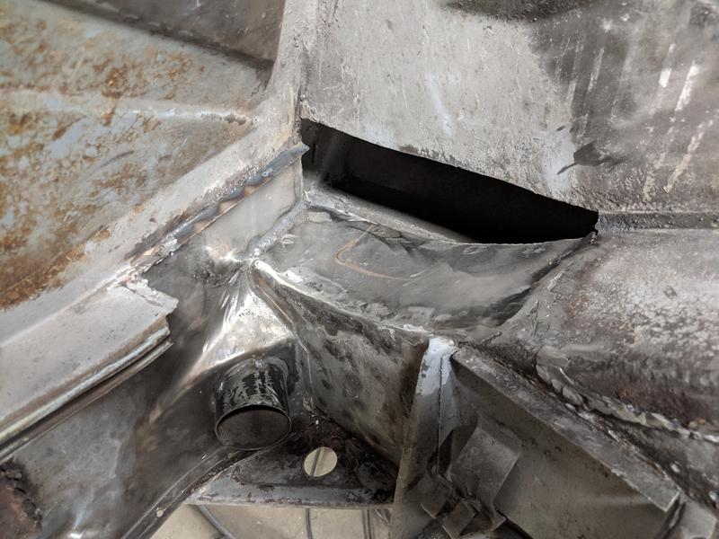

Patching the firewall:
(IMG:http://www.914world.com/bbs2/uploads_offsite/i.imgur.com-23821-1587188452.2.jpg)

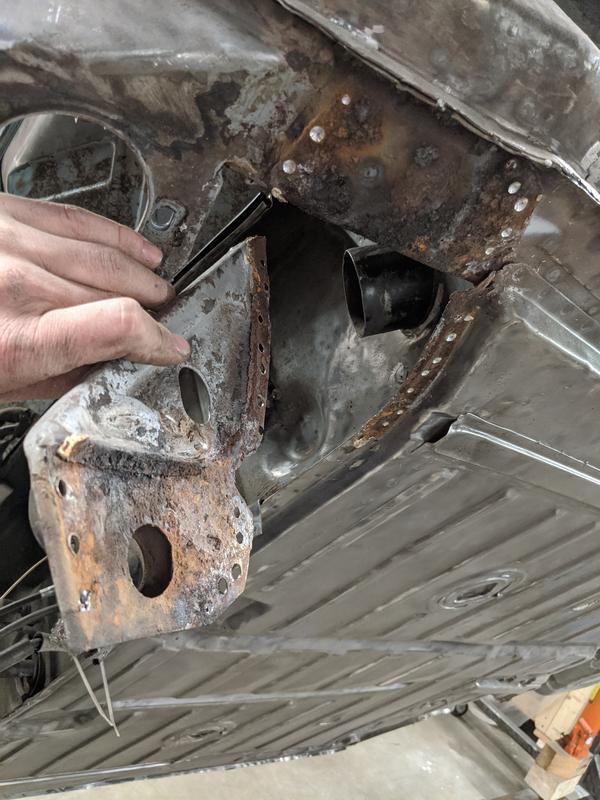

"Rust free" from the outside:
(IMG:http://www.914world.com/bbs2/uploads_offsite/i.imgur.com-23821-1587188452.3.jpg)

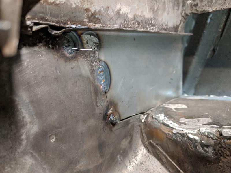

NOT rust free:
