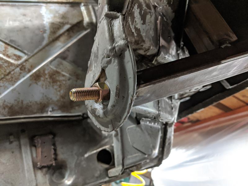

Getting ready to replace the suspension console. I used a 9/16th bolt and welded a quick bracket to locate the hole. Not sure this is the most reliable way to do it, but it seemed like a good idea at the time.
Bracket:

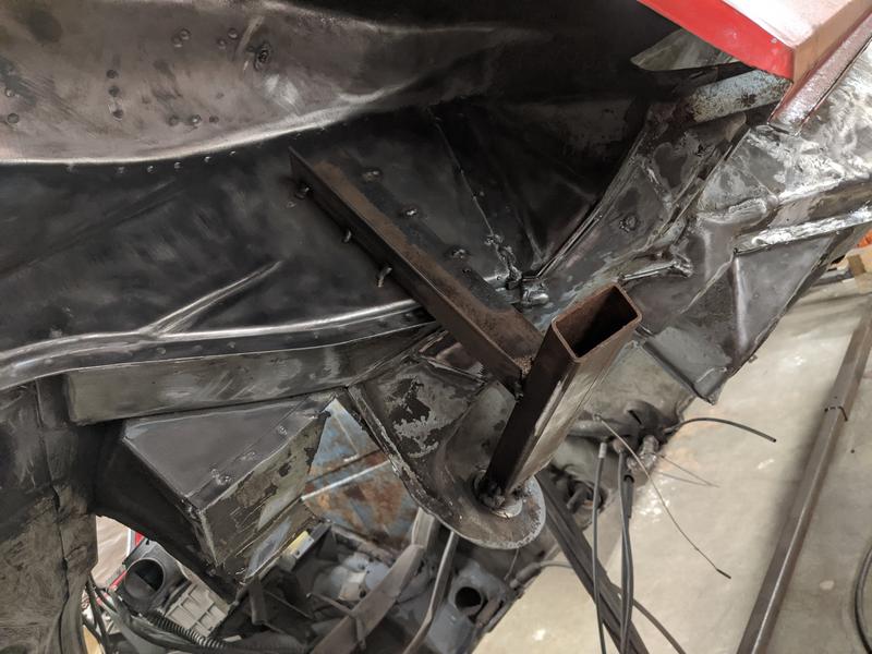

Had to see, but there's a bit washer welded to other side that is keeping it flat:
(IMG:http://www.914world.com/bbs2/uploads_offsite/i.imgur.com-23821-1587264636.1.jpg)

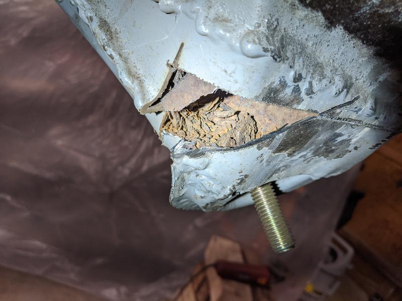

Cutting into the suspension console, gross!
(IMG:http://www.914world.com/bbs2/uploads_offsite/i.imgur.com-23821-1587264636.2.jpg)
