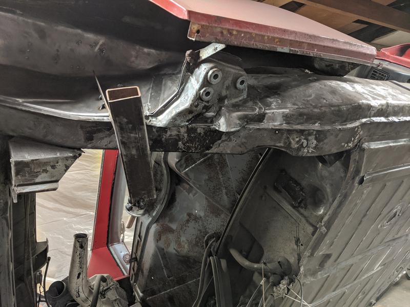

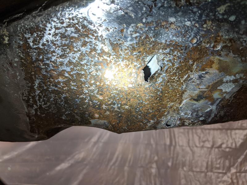

The inside longitudinal behind the engine bar mount and suspension console had been "bathed" in battery acid. This resulted in some severe pitting, but everything inside the long (based on several holes I poked through it) is rust free. I've already seen the inside of the long and fixed what needed fixing. I think for this area I will treat the rust/paint and add a 20ga sheet to the outside.

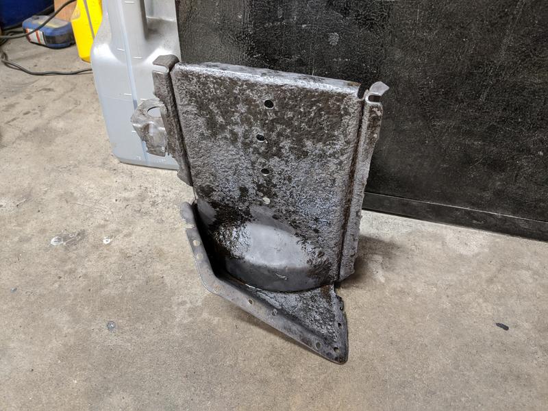

Suspension console (and engine bar mount) cut off: (IMG:http://www.914world.com/bbs2/uploads_offsite/i.imgur.com-23821-1587264951.1.jpg) Found the soft spot on the inside of the long behind the engine bar mount and punched a screwdriver through it. The metal was thin in this spot, but the area behind is rust free: (IMG:http://www.914world.com/bbs2/uploads_offsite/i.imgur.com-23821-1587265281.1.jpg) Engine bar mount, pitted, but solid: (IMG:http://www.914world.com/bbs2/uploads_offsite/i.imgur.com-23821-1587265282.2.jpg) |
