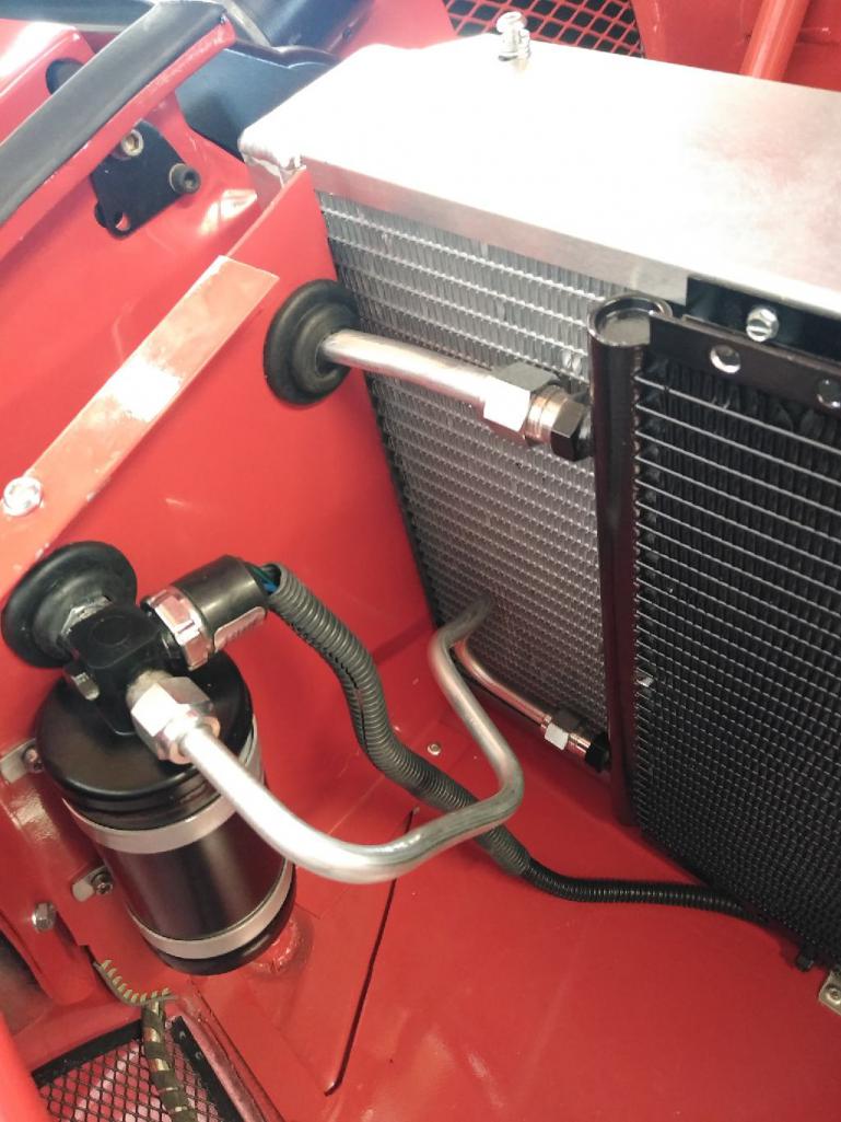

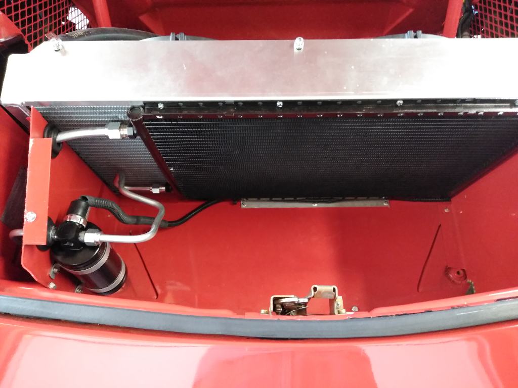

Got some more work done the past couple days. Condenser is plumbed and wiring for trinary switch almost complete. I used a couple aluminum tubes for simplicity and to help where the rubber hose might have kinked.
Everything is a compromise right? I decided to go with the smaller condenser for a couple reasons. I didn't like the options I had for mounting the receiver/drier outside the current location; a lot of heat behind radiator and no room inside the cabin. The condenser is a high efficiency one, so not overly concerned with its ability to cool the small interior.
I have heard of many people having issues keeping their V8 engines cool, and I have never had a problem. Hopefully this won't be the start of any (IMG:style_emoticons/default/idea.gif)

FL 000   Condenser hoses go under and then up behind the ta...   Apr 18 2020, 09:15 PM
FL 000   Here's a pic of the hose going to the evap. It...   Apr 18 2020, 09:24 PM
914pipe   Very Nice!!!   Apr 18 2020, 09:42 PM
tygaboy   That's a tidy install! :trophy:   Apr 18 2020, 10:53 PM
